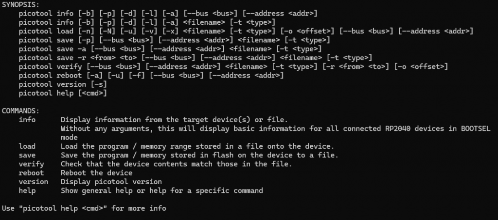

This is how I do it.
Start with a working MMBasic program including options set, etc.
1.  Download picotools: https://github.com/raspberrypi/picotool
2.  I had to install a driver using Zadig from https://zadig.akeo.ie/
3.  Plug the Pico in while holding down BOOTSEL switch
4.  Run a command window where pocotool.exe is located
5.  Run this command: picotool save -a filename.uf2

I tried it with my RP2350 and got:
Shouldn't matter whether RP2040 or RP2350, right?
Posts: 8965
Posted: 05:22pm 12 Dec 2024
There is a bootrom in the RP devices. It looks like it might be programmed differently in the RP2350. Nothing you can do about that other than wait for a new picotool to be released.

Hmm, what do I have to enter for "Source device selection"?
       --bus <bus>
           Filter devices by USB bus number
       --address <addr>
           Filter devices by USB device address
Frank

Hi Frank,
I believe that is optional:
However, if you try running Picotool with the device NOT in Boot mode:
It should be as simple as the example given by Geoff but I suspect that he has SDK-2 with the updated Picotool.

I was not in bootloader mode and my batch call was also wrong...
I have just successfully read, deleted and rewrote a Raspberry Pi Pico...
Frank
