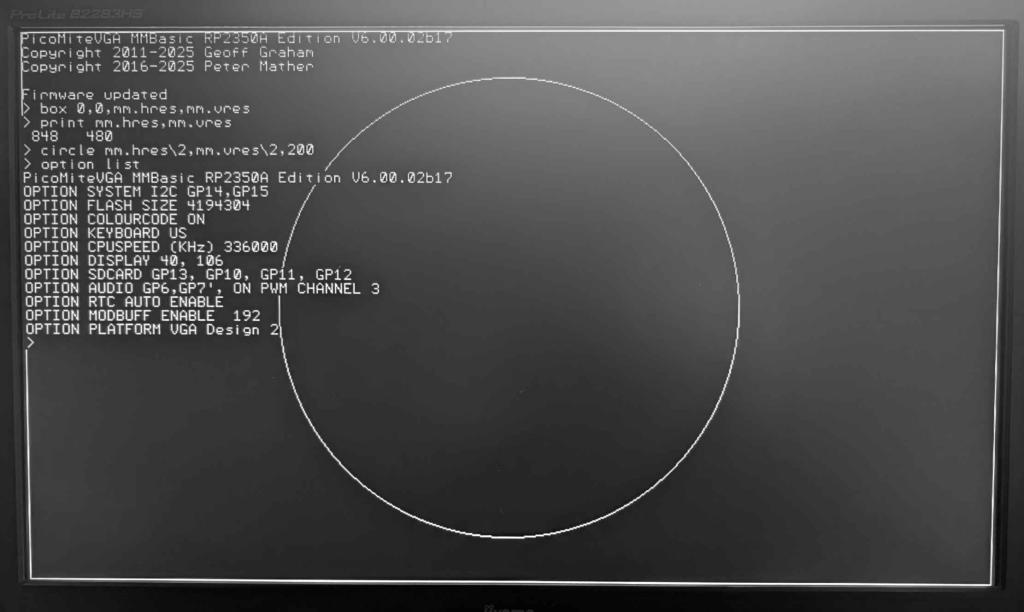

Posts: 11828
Posted: 07:24pm 10 Mar 2025
I've updated the betas for HDMI and RP2350 VGA to b18
These now all support 848x480 widescreen - same as mode 10 on the CMM2
To use the new resolution on HDMI use:
OPTION RESOLUTION 848
Valid modes are:
1: 848 x 480 x 1bit with tiles
2: 424 x 240 x 4-bit with 1 layer buffer
3: 848 x 480 x 4-bit
5: 424 x 240 x 8-bit RGB332
On VGA use:
OPTION WIDESCREEN ON/OFF
Valid modes are:
I assume only a proper widescreen monitor will show these correctly. CPU speed is 336MHz for both VGA and HDMI
Edited 2025-03-11 05:25 by matherp
bfwolf
Joined: 03/01/2025
Posts: 257
Posted: 08:51pm 10 Mar 2025
  matherp said
Re: a previous comment about the DS18B20 not respecting the resolution - it does
However if the actual temperature is 23.5 all resolutions will show 23.5. If the actual temperature is 23.625 then resolutions 0 and 1 will show 23.5 and 2 and 3 will show 23.625.
Did you mean my comment?
I didn't mean to suggest that it was the software..
So if the DS18B20 receives the data correctly, it should also set the resolution and timing correctly.
But suppose 1 or more bits were received incorrectly by the DS18B20 (e.g. due to interference or because it's a "bad chip")? Then it could be that it takes the measurement with 11 or 12 bits of resolution and of course takes longer to do so.
That would also explain why an additional delay seemed to help.
Regarding the new widescreen modes: Nice feature!
bfwolf
