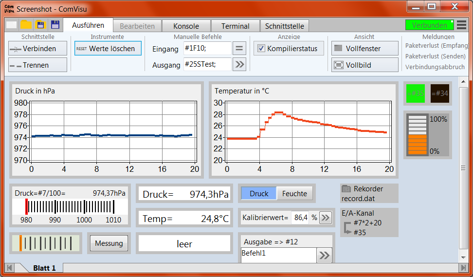

  bfwolf said  Maybe interesting for others?
Not a project of mine, but know it since several years..
http://www.comvisu.de/descreenshots.htm
Sample screenshot:
GUI language may be switched from German to English but manual only available in German language!
Available for Windows, Linux and Raspberry Linux..
Communication with microcontroller boards possible via RS232 or TCP/IP..

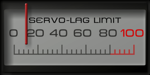

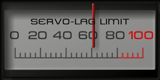

I use Knob Studio to create my own GUIs.
Too many GUIs just look the same-ish/20th century, IMO.
Sample of my knobs and gauges:
