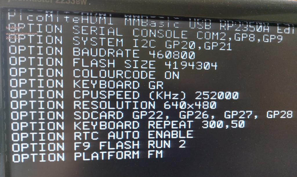

  toml_12953 said  ... On page 30 it says that HDMI requires a clock speed of up to 372 MHz. The WiFi chip can only go to about 252 MHz without damage so the system is too slow to allow HDMI.
Maybe the manual shows something wrong, at least for Mode 1?
