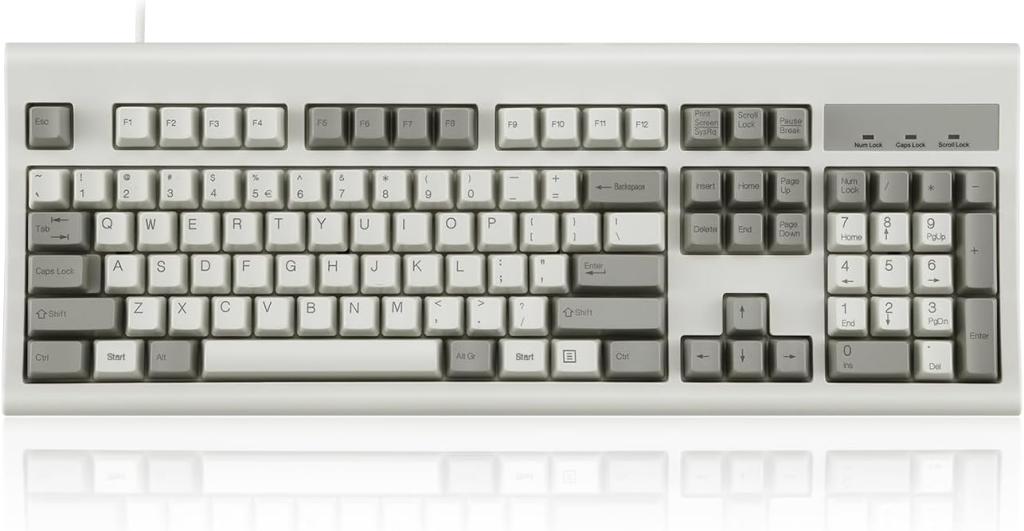

I've used these three, and they all work.
I wouldn't recommend this one - it works fine, but not having dedicated Function keys is a bit of draw back with the CMM2
https://www.amazon.ca/dp/B0BD6X9TQZ?ref_=ppx_hzsearch_conn_dt_b_fed_asin_title_5&th=1
I love this keyboard for my CMM2. But it's full size, and you did ask for compact (photo below).
