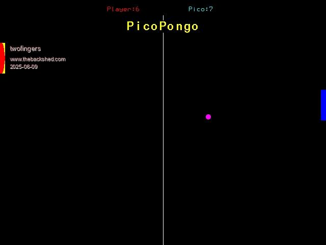

This is PicoPongo, my version of Pong for Picomites.
The HDMI (Mode 3) game is designed for solo players against the Pico and keyboard control.
Help key is 'F1'.
Cursor up = Paddle up
Cursor down = Paddle down
't' = Sound on/off
's' = Screenshot
'p' = Pause
Esc = Exit
Have fun.

Something wrong here. The ball isn't square. :)

I'd like to know if HMDM mode 3 is identical to VGA mode. The reason is that I want to add the Pong game to Harm's thread, in case it's compatible. The manual isn't clear on this.
I've modified the Picopongo slightly. The design has been changed, and the ball speed automatically increases after 20 points (total). The game ends after a total of 60 points. Follow the white rabbit ...

In case you use resolution 640x480 on HDMI mode 3, the resolution is the same as VGA mode 1. But the way color is made is totally different (VGA uses tiles, HDMI mode 3 can use individual colors).
I will look at your code and see if it can be modified.
P.S. in VGA mode 1 it is black and white. In VGA mode 2 the game in essence works but it is not really playable. The bats move far too slow (you cannot change the keyboard repeat in a MMBasic program for a PS2 keyboard, you need to set it on the commandline.).
And the bats and rabit are huge... But that is kind of fun. I think this game could be adapted to work on VGA mode 2 relatively simple.

In principle, I could also rewrite it for Mode 2 (320x240). But the keyboard query is probably the party killer. Without adjusting the repeat rate, the keyboard control makes no sense (to slow!). And I wanted something simple, without any tinkering.
By the way, a second "ball" is inserted in the code. The sprite generation was done with a standard image editing program. However, strange, unexpected things sometimes happen during the RGB121 conversion.

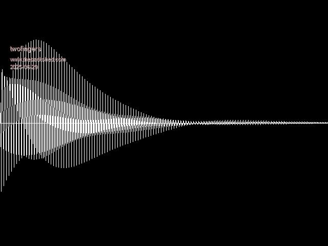

What's new in this version?
1. I now use sound effects.
2. The game can be easily restarted for endless fun.
It's almost finished now; a two-player mode could be added, and the options could be saved in a config file.
Side note:
My goal was to develop an easy-to-use single-file program. This made things a bit more complicated.
I didn't expect I'd have to get into synthesizer building to develop this game (envelopes, ADSR, beating). I'm surprised it's so easy with our PicoMite (after all).
I was able to learn a lot about the intricacies of the "PLAY LOAD SOUND" command for user-configured sounds. Unfortunately, the command is poorly documented. But ultimately, it is possible to play very different samples with this command.
The sounds used were calculated by the Pico itself and then saved as DATA lines. They often displayed beautiful diagrams like this one.
