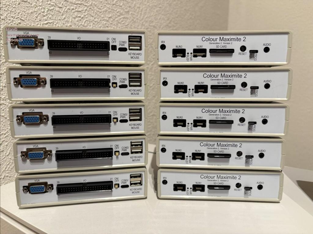

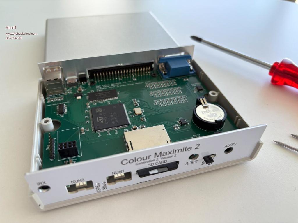

PS: just assembled and shipped ten of the CMM2 G2 V2:
Edited 2025-06-29 08:57 by ManiB

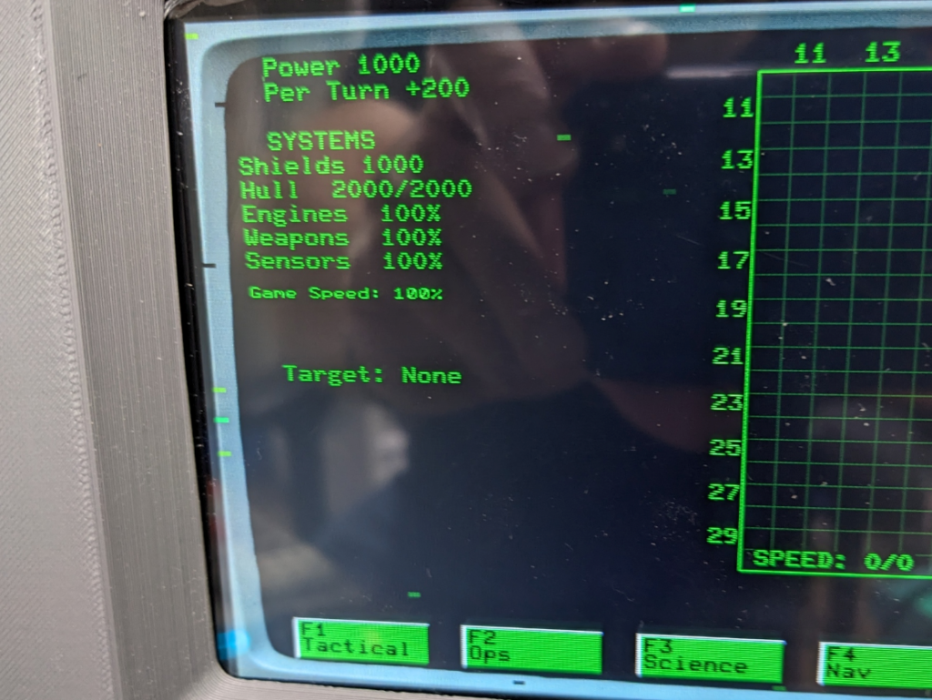

Sorry Peter, but although the keyboard is working again, I'm getting weird artifacts when I try to access the graphics memory.
PeteCotton
Joined: 13/08/2020
Posts: 667
Posted: 08:51pm 29 Jun 2025
This is the minimal code needed to check for artifacts

Where crt.jpg is this file:
crt3.zip

Do you see any issues other than with LOAD JPG?
PeteCotton
Joined: 13/08/2020
Posts: 667
Posted: 03:58pm 30 Jun 2025
  matherp said  Do you see any issues other than with LOAD JPG?
I can't see any other issues apart from JPG loading. I ran through a few programs and they all seem to run fine (although I don't have speakers attached to test sound).
From my perspective, I can probably work around not using LOAD JPEG. The only reason I was using it (if memory serves) is that it loads much quicker than a BMP (but I might be wrong on that).

Try this. I've replaced the entire jpg module with the one from the Pico. S/W rather than H/W but more flexible - can load jpg bigger than the screen
CMM2V1.5.zip

  matherp said  Try this. I've replaced the entire jpg module with the one from the Pico. S/W rather than H/W but more flexible - can load jpg bigger than the screen
Initial testing seems to confirm that yes - it is fixed. I will try and do more extensive testing tomorrow. I did quite a few reboots, and can confirm that the keyboard also always works every time.
Thank you once again Peter   As always - outstanding work!
