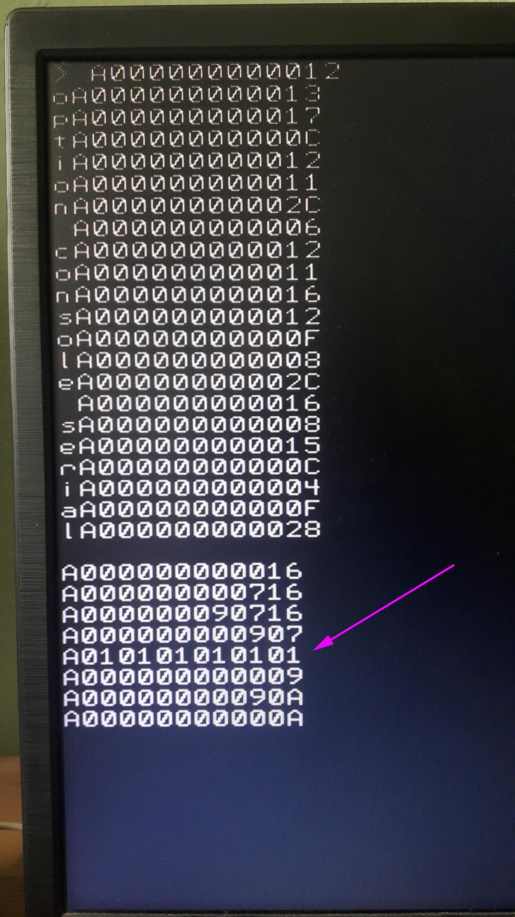

  matherp said  On my USB keyboard, I only ever see duplication of the "H" character and when it is duplicated I get the nonsense code A010101010101 on the screen and it is this which causes the duplication.
Google does not suggest this is a generic error code but it is definitely the keyboard that is generating it.
Peter, see:
https://www.usb.org/sites/default/files/documents/hid1_11.pdf
Universal Serial Bus (USB)
Device Class Definition for Human Interface Devices (HID)
Firmware Specification—6/27/01
page 62 (72/97 in PDF) reads:
"The keyboard must report a phantom state indexing Usage(ErrorRollOver) in
all array fields whenever the number of keys pressed exceeds the Report
Count. The limit is six non-modifier keys when using the keyboard descriptor
in Appendix B. Additionally, a keyboard may report the phantom condition
when an invalid or unrecognizable combination of keys is pressed."
page 74 (84/97 in PDF) reads:
"- The Boot Keyboard shall report “Keyboard ErrorRollOver” in all array fields
when the number of non-modifier keys pressed exceeds the Report Count. The
limit is six non-modifier keys for a Boot Keyboard.
when combination of keys pressed cannot be accurately determined by the
device, such as ghost key or rollover errors."

ie, 0x01 in each of the 6 array positions: "010101010101". hopefully this should help.
rob   :-)

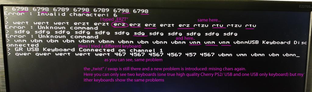

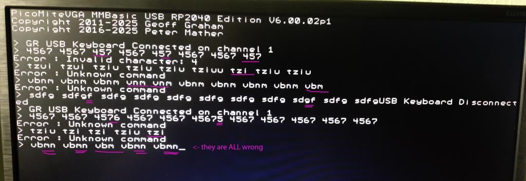

Same problem, but to be sure I generated the MD5 checksum, so that you can compare the version:
Md5 Checksum online tool: https://emn178.github.io/online-tools/md5_checksum.html
It gives me "3971224a263653cd6881573a34df4d7a" for your file.
Here sadly the same problems, new image:
Posts: 12060
Posted: 02:40pm 07 Jul 2025
Please just run a single finger across vbnm as fast as possible - what happens?

Ok done.
With a single finger I wasn't able to produce any false chars or missing or swapped chars. Then I tried to write in my maximum speed in german and english (a bit slower), here I can't replicate any of the mentioned "problems". It only appears if there is rollover involved. And this (rollover?) problem with the group of "VBNM" starts really quickly, I must not type fast that the problem occurs. But what (for me counts) I wasn't able to re-create any of the mentioned problems with normal writing.
Before your fixes, I wasn't able to write the word "save" for example. Now with an english text and some keywords I tested, the problem isn't re-producable under normal circumstances. So for me, as said a few post ago, absolutly usable now. Although the problems persist under the mentioned circumstances, I think we have to live with that - which is fine because:
only a few people have those problems
and as it is now with the fixes, it is even for me highly unlikely that I run into problems again.
So I think further fixes will be just for sports (is it even called this way in english?)
Edited 2025-07-08 01:00 by Amnesie

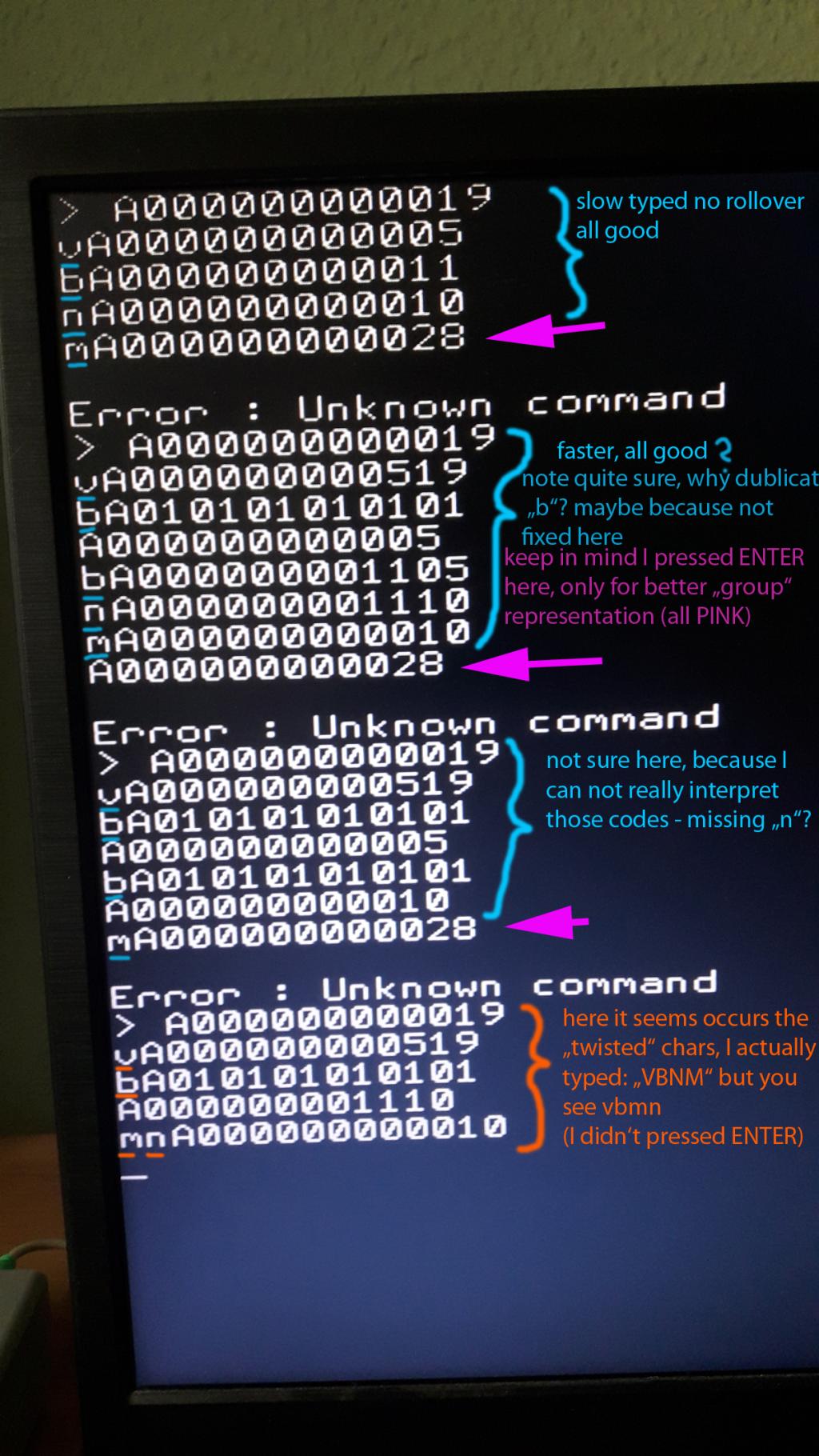

To sum up:
- You fixed the missing chars (this was the worst problem!)
- the dublicate chars (was a bad problem, too)
Now there are still swapped chars and when typed really really fast with rollover there is a missing char again (latest firmware ONYL)
So yes, last night version was the best, under normal circumstances I see no way of having any problems with it.
Edited 2025-07-08 01:11 by Amnesie

Joined: 30/06/2020
Posts: 763
Posted: 10:52am 08 Jul 2025
  matherp said  Once more unto the breach, dear friends
This is the Thursday lunchtime code with one tiny tweak. Assuming nothing untoward I intend to do a patch release of V6.00.02 with this change and a couple of other bugs fixes (PLAY SOUND n,R)
PicoMiteRP2350VGAUSBV6.00.02.zip
Tested all keyboards again, only when "typing" really fast (with rollover on the groups of four) I still get the described things like:
VBNM:  vbmn vbm vbm etc..
4567:  4576 457 etc..
But as mentioned, I don't see a chance for normal (or even fastest) writing that those problems will ever come up. I wrote some english keywords and also some english text and german text as fast as I could; no problems.
To summarize: Problems with certain (!) keyboards will persist, but fixed to a level, I don't see any chance to be problematic in real life.
So thank you for fixing it to this point, so that this usb-firmware is usable for those who got those problems. I can imagine it was really hard, specially because not everyone can replicate it.
