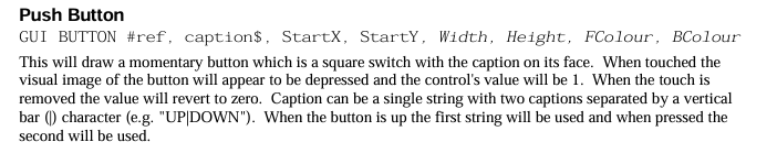

try this for my button
GUI BUTTON     #25,chr$(100),  240, 60, 60, 30, RGB(white), RGB(orange)
dont now what chr$ i need for it

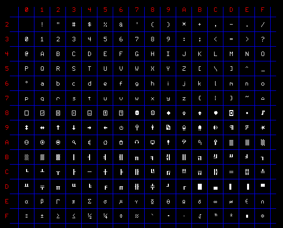

Posts: 6629
Posted: 04:48am 22 Jul 2025
Using font 1, chr$(&h92) to chr$(&h95)
https://www.thebackshed.com/forum/ViewTopic.php?FID=16&TID=18132#242212

Font1 table here:
According to the manual, the button works like this:
/Peter63
