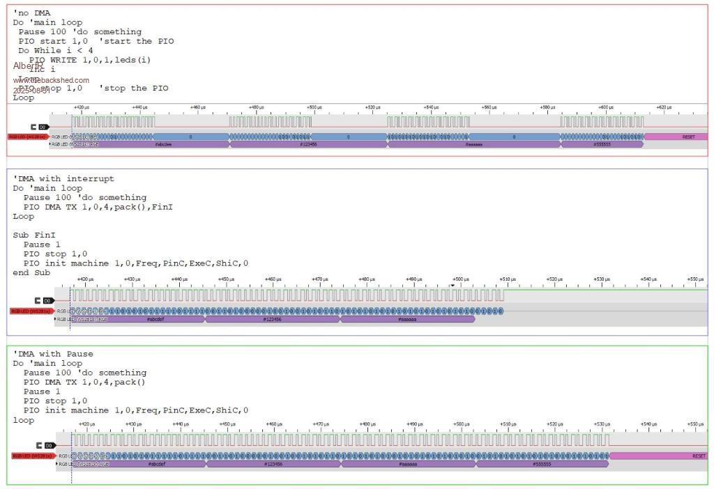

I make some tests with the Picomite PIO for the WS2812-Output.
Because the implemented function "Device WS2812" is blocking during output-time, I was looking for an other possibility. The PIO should be a candidate.
Option EXPLICIT

For testing the PIO-program I use the "PIO WRITE" command, DMA with interupt and with
Pause. Thats the results:
1. PIO WRITE always kills the last bit. If CPUSPEED is only 150MHz it generates a "Break"
2. PIO with TX-DMA works very good but if I use the Ready-Interupt it stops the PIO, even if there is some data left in the OSR and even if there is no PIO STOP in the sub.
3. The version with "pause 1" works spable, but then I am blocking again. That is not what I expected when I use DMA.
I think I am not the only one who use PIO. Where did I thing wrong?

Ok, a non blocking solution could be, using a Timer-Interupt with precalculated delay.
'Do 'main loop
 ' do something
 Do : Loop While Busy               'wait for ready
 Memory pack leds(),pack(),1024,32 'copy and pack
 Busy = 1                          'set busy-flag
 PIO DMA TX 1,0,1024,pack()',FinI
 SetTick 29,FinI,1 ' 29us/24bit
End
'subs/functions -------------------------------------------------------------
Sub FinI
 'stop the PIO and re-init for next run
 SetTick 0,FinI,1
 PIO stop 1,0
 PIO init machine 1,0,Freq,PinC,ExeC,ShiC,0
 Busy = 0 'ready to start
End Sub
But is this the right way/solution?
Albert
Posts: 12058
Posted: 12:54pm 31 Aug 2025
PIO DMA TX waits before firing the interrupt until the fifo is clear. It can't know the status of the OSR or any other PIO internals so there is no way it can wait until the PIO finishes before stopping the processing. Your workaround is probably as good as it gets. When the PIO is running a faster process then the inherent delay in the MMbasic interrupt firing masks the issue.

I already thought to myself that the FIFO clear is the trigger, but why did the PIO stops by calling the Interupt. In the examples from the manual there is an additional "PIO STOP"? A "pause 1" before it has no effect.
