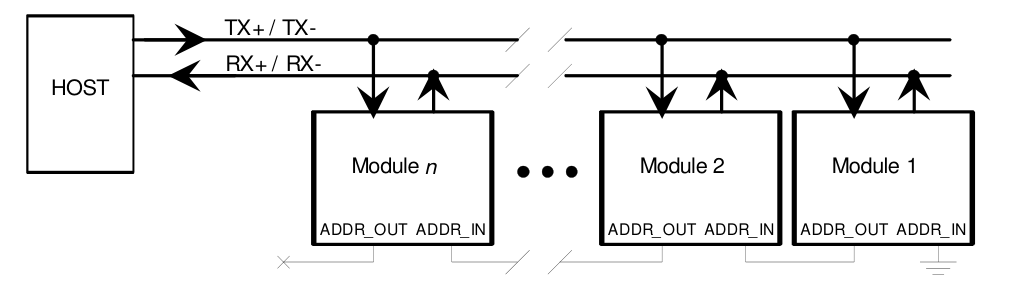

Hi Phenix,
Thanks for the details, below is my idea's about it (constructive critics).
First of all a generic question ? Why not use MODBUS. It does exactly what you plan to do. But let's go to your proposal.
There are 2 options:
1/ you design for single-drop RS422. In that case you can drop the address byte, since you know where the cabe is going, and one of the commands in your 16 wide command set could be "identify".
2/ you design for multi-drop RS422/485/rs232. In this case there is 1 master, and N slaves. The slaves have to synchronze the the masters message stream, and pick out the packets that are target to this slave. Therefore it has to (partly) decode the message. This means the slaves have to keep up with the masters datarate. This is why I would change the protocol.
To be as fast as possible, you need to let the ARM doe the work, so make use of only a few efficient MMBasic commands. The commant I particularry have in mind is: LINE INPUT. This reads (ARM) UART data until it hits a <CR>.
In your proposal you started with a header byte... drop that.. and add a termination byte..&h0D (or <CR>). That means that you can read a whole message with one command.
There is a drawback... &h0D cannot be part of the message. Unless we use some creative thinking.
Message proposal:
-control byte (lower nibble = type of operation, upper nibble = number of data bytes to follow)
-address byte (for multidrop RS422)
-data byte
-data byte
-data byte
-data byte etc.
-checksum byte.
-termination (<CR>)
Note that I swapped nibbles in the control byte. By doing this the mosy significant nibble contains the length, and the message length is never equal to zero (the control byte itself is 1 byte), so &h0D cannot be in the control byte (high nibble cannot be 0). This means that the message length can always be read at left$(a$,1), and be compared with the length of a$. When not long enough,, do another LINE INPUT, until length parameter, and length of the string match. If you want to drop of early: when the length is >2 you can stop decoding if the address is not your address. But you have to read the whole message (length=len(a$)) to make sure you capture the termination<CR>, and stay in sync with the stream.
Since the data inside the message can be any value (also &h0D) statistically each byte (16 max) can be &h0d (chance 1 in 256), so 1 in 16 messages will be a half message (or part of a message), and needs another LINE INPUT to construct the message.
I hope this make sense. There is still a lot of MMBasic going on, but the most time critical is solved in ARM code (LINE INPUT).
I hope this helps.
Edited 2025-09-03 17:00 by Volhout

  Volhout said  Hi Phenix,
Too clunky, only half-duplex and I can't use MMEdit to directly edit the code of each PicoMite.
The Windows system is merely Data input/output but the PicoMites handle all of the sequence control.
It becomes a true multiprocessing and multitasking solution. Need another process...add another PicoMite.
I am unaware of anything on the market that can do this.
Each PicoMite that is connected via USB can be a sub-master. If can command other PicoMites via UART/RS422 Full Duplex Multidrop.

Posts: 9238
Posted: 07:59am 03 Sep 2025
I personally wouldn't use USB full stop. There's no real reason to and it exposes the console input, which to my mind is insecure even if it does make things easier. RS485 would only use 2/3 pins and you still get the buffered COM port. It simply has too many advantages to list, although you'll have to splash out a quid for the chip and a terminator. :)  You can even have full duplex if you want. If you simply have to have both UARTs available then it's definitely possible to write another UART using a PIO. There's an example in the Datasheet. It's just that MMBasic won't recognize it natively.
Of course, if you are using a USB hub and the Picos are less than 1m away from it you are probably ok using that. The leads cost more than the RS485 chip though. :)

Posted: 08:22am 03 Sep 2025
Each UART with MAX3491 becomes FD
This is what I've been doing:
What has worked extremely well for me is remote installations (apart from time zones  ) and diagnostics.
I do quite well with hooking-up to my Android tablets via TeamViewer but editing code has always involved some inconvenience.
This approach would make things a little bit easier. Clients love it because they avoid the costs associated with me having to be there.
I'm not worried about USB. There are industrial USB devices on the market.
