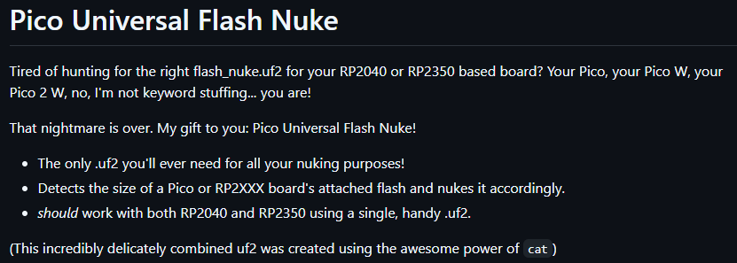

Posted: 08:57am 02 Sep 2025
For both RP2040 and 2350

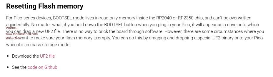

Posts: 6197
Posted: 09:48am 02 Sep 2025
From the makers themselves..
Download here (bottom page):
here

Posted: 11:55am 02 Sep 2025
Clear flash.uf and the one for the 2350 seem to work too

Posted: 12:23pm 02 Sep 2025
  Bryan1 said  Clear flash.uf and the one for the 2350 seem to work too
Yes. I asked ChatGPT to be sure I had the correct ones and it pointed me to the universal one. Works for me
