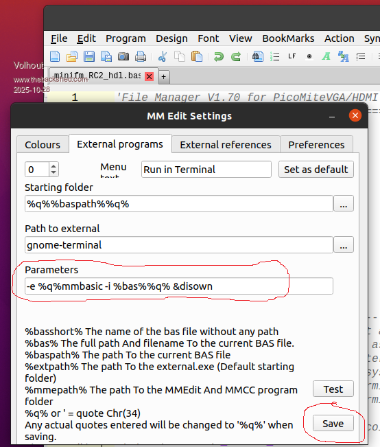

If you had enough beer, resulting in enough courage, you could install MMB4L on your Linux system. Tom provided nice instructions for that.

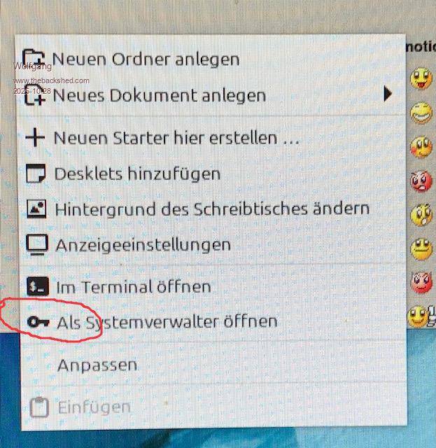

Then, in MMedit5, in the tab FILE/PREFERENCE you can make following changes:
Then you can run programs directly on your PC (without a mite attached).

Thank you very much for sharing your experience. What I take from this is, that I will also create an external clone boot HD for my Linux Mint. I don't know yet how to do that, but I'm confident I'll figure it out in time.
@all
I am well aware that this is a Pico forum and, as I have read, Linux Mint problems have also been addressed here.
And based on that, I have not had any success with the helpful suggestions here for getting back into my Linux Mint 22.2.
Everything I try to recover calls me to enter the password. And a new password is also accepted in case of inputting it via passwd „newpassword“ but I further can't access Timeshift or User and groups. All other programs can be accessed.
I didn't think it would be so difficult for beginners in Linux that one was virtually blocked and can't update anything to return to the original state.
I think therefore its the only measure to completely update my PC and only use MMedit either in a VM or on one of my Windows PCs too.

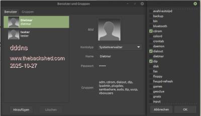

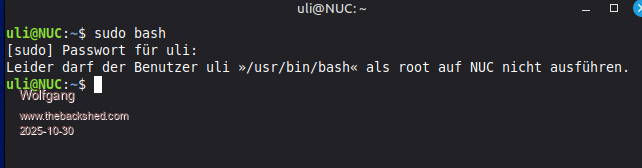

What exactly happens? You can login and desktop comes up?
You want to go to e.g."users and groups" and an administrative password is asked?
You enter _your_ password and it refuses to process and says "wrong password"??
In the latter case the only solution is to boot it with the stick, mount your root partition and fix the problem.
Edit:
If your Mint desktop comes up and you don't need to enter a password, then it might run in public "kiosk" mode. Then you are not logged in with your useraccount and then your password won't work.
Try to click on logout (abmelden) and see what happens. Is there a choice of usernames in the login window?

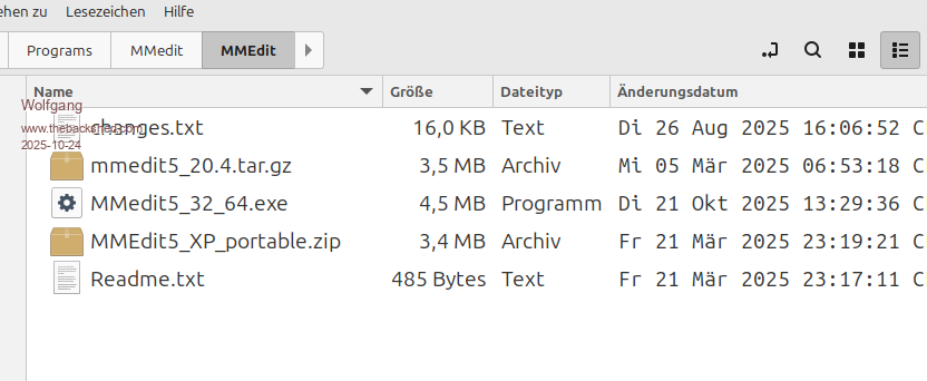

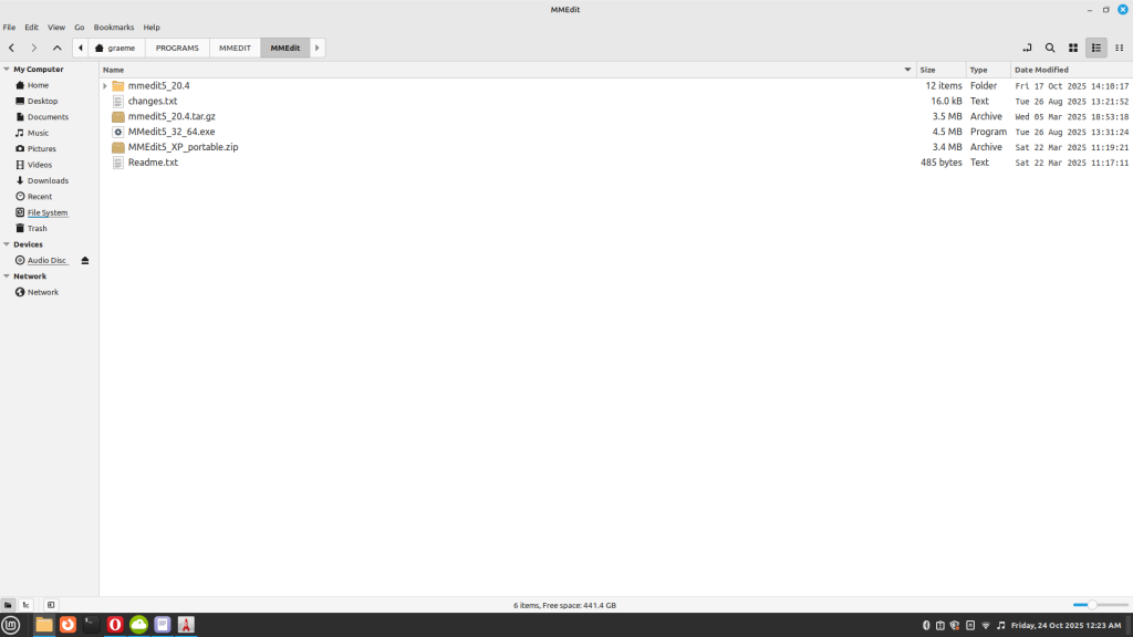

For information: My system is a NUC5i3RYH with 16Gb M2.Ram on which the operating system and the additional standard Linux-programms are located. All timeshift files are located on an external 1TB USB3.0 SSD.  The NUC is intended exclusively for Mint. qt5-dev was installed.

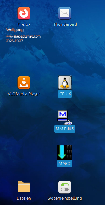

Linux Mint 22.2 Zara starts without asking for a password, as was the case before  attempting to integrate MMedit into Linux.
MMedit under WINE, which I had set up previously, ran ok except for integrating  the serial port, which I was unable to achieve.

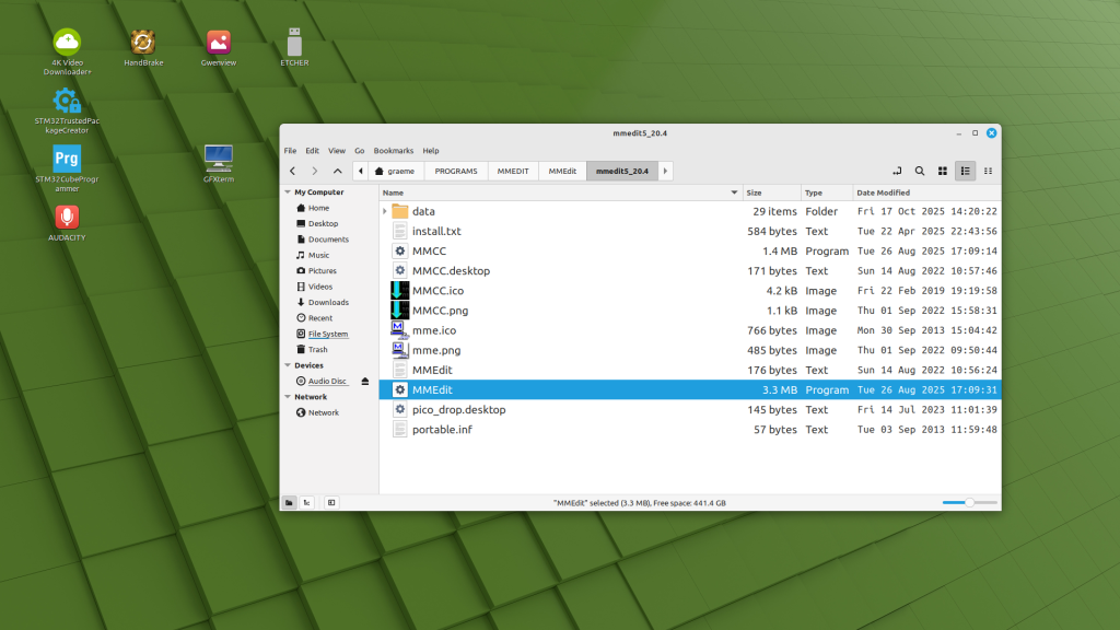

I then deleted this WINE-MMedit completely and tried the *.tar.gz Linux version. After unpacking and following the infos from Grogster, the generated ICON did not produce any reaction.
I can also use all programms without restrictions, but those that previously required a password do not respond at all, as if they did before.
When logging out (Herunterfahren), no further information appears: Mint shuts down without any further display-Output.

But anyway, open a terminal and post the complete dialog output of
sudo bash
It will ask for a password and that is your password.
Please post all lines
Edited 2025-10-30 03:39 by dddns

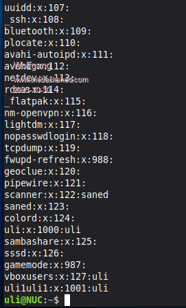

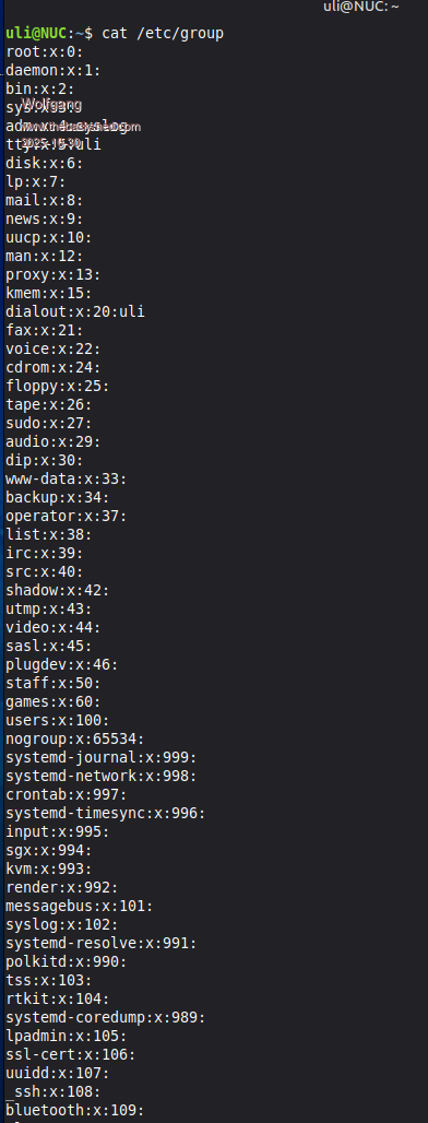

ok. Post the output of
cat /etc/group
Is your username in the group "sudo"?
Wolfgang
Joined: 03/11/2021
Posts: 88
Posted: 07:16pm 29 Oct 2025
@dddns
My current password is not in the list, only my very very first one. Due to the problems I was having before, I tried to enter a new one using Linux passwd ‘newpassword’, which lets me now login into the system after ‘Abmelden“.
Due to the long listing as response to cat /etc/group you find two parts of the list.
The very very first password is in the last position of second part.
First-part:
second-part:
Wolfgang
Edit. I hope it is what you can use?
Edited 2025-10-30 05:19 by Wolfgang
dddns
Joined: 20/09/2024
Posts: 924
Posted: 08:22pm 29 Oct 2025
Boot with your stick.
Use filemanager and click on your root partion. Then goto etc subdirectory.
Right click and chose "open terminal here"
Edit file group with:
sudo nano group
Add your username behind: sudo:x:27:
Ctrl-x to exit and save.
Reboot and it should be fixed
Wolfgang

I think what has happened is simple: you changed something in "user and groups" and unchecked the group "sudo" for your username, thus can't execute sudo anymore..
The way I described puts it back in, that's it.
