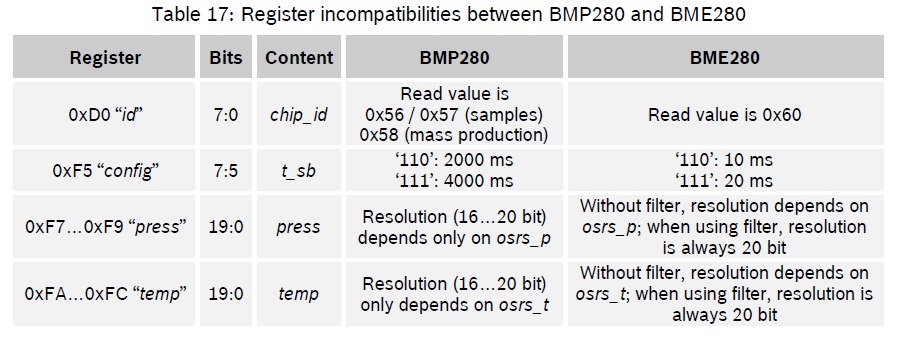

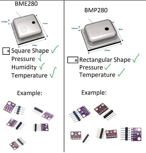

The program runs but at first I get an error "BME280 not found"  at line 98.
The program continues to run after this with correct Temperature and Pressure values but Humidity is 0.
The value of i% in line 98 is 88.

Posts: 6626
Posted: 09:12pm 16 Feb 2026
You have a BMP280
not a BME280
Chip ID for the BMP280 is 88 decimal = &h58
The BMP280 uses the same registers for temperature and pressure which is why you are getting readings for those.
Edited 2026-02-17 07:14 by TassyJim

Posted: 09:52pm 16 Feb 2026
  Quote  Chip ID for the BMP280 is 88 decimal = &h58
That is the value I get in the error message.
I still don't know what to do to fix it.  I bought the sensors as BME280, I can't take a picture because I can't find the memory card for my camera but the markings in the module are...

Posted: 10:16pm 16 Feb 2026
  Quote  GY-BM
  E/P
  280
The same board is used for both chips.
If you are lucky, there will be a mark crossing out the E or the P.
The question is then, does crossing it out mean it is a P an E.
The actual chip do look different.
search for "bmp280 vs bme280"

Posted: 10:28pm 16 Feb 2026
OK it says BMP280 does not measure humidity. so look for BME280.

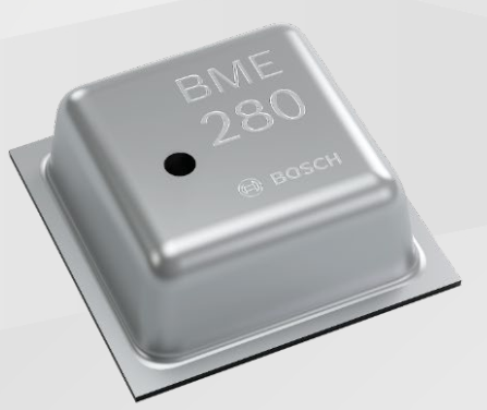

Posted: 10:46pm 16 Feb 2026
The type number should be engraved on the tiny metal box.

Posted: 11:07pm 16 Feb 2026
Or with batch markings:
  Quote  This is the smoking gun. If you look at the BME280 datasheet, on Page 44, the markings for mass production devices is shown. The marking should be in the format ??? U? where the U indicates BME280. The final ? is only a P according to this revision of the datasheet as there is only one subcontractor, so the last two characters should be UP.
Comparing this with the BMP280 datasheet, on Page 41, the format should be ??? K?, where the last ? is either P, U, N, W. Thus KP, KU, KN, KW are all BMP280 devices.

Posted: 12:24am 17 Feb 2026
Thanks for that.
Mine is KU so it is a BMP280.
