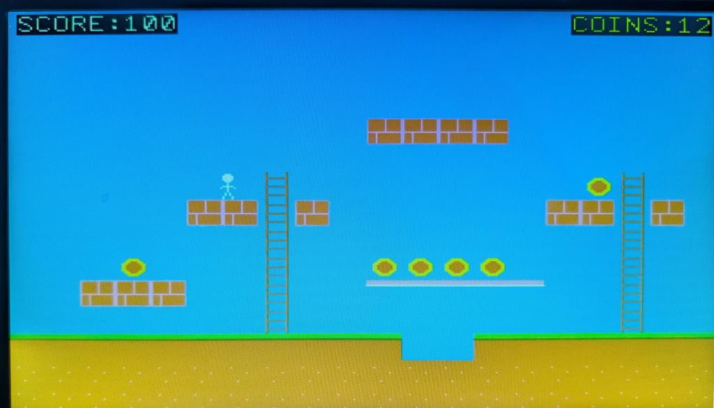

By request, attached is a sort of proforma example platform game programmed using the TILEMAP command. It is fully functional (HDMI or RP2350VGA) and extensively commented so should be useful as a starting point for any sort of platform type game.
' PLATFORM - A Tilemap-Based Platform Game
' A complete reference implementation showing
' how to build a side-scrolling platform game
' using the TILEMAP engine. Techniques covered:
'   - Procedural tileset generation (drawing
'     tiles at runtime, saving as BMP, loading
'     into FLASH for the TILEMAP engine)
'   - Scrolling camera across a world wider
'     than the screen (map is 2x screen width)
'   - Tile-based collision detection using
'     TILEMAP(COLLISION) with attribute masks
'   - Gravity, jumping, and ladder climbing
'   - One-way platforms (stand on top, pass
'     through from below)
'   - Coin collection via TILEMAP SET to
'     replace tiles at runtime
'   - Sprite animation using TILEMAP SPRITE
'     SET to swap between tile frames
'   - Double-buffered rendering with
'     FRAMEBUFFER for flicker-free display
' Game Structure:
'   1. GenerateTileset draws tiles to screen,
'      saves as BMP, loads into FLASH
'   2. Title screen waits for input
'   3. TILEMAP CREATE builds the map from DATA
'   4. Main loop: Input -> Physics -> Collision
'      -> Animation -> Draw -> Repeat
'   5. Win/Lose screens loop back or exit
' Controls: Left/Right arrows to move
'           Up arrow to jump / climb ladder
'           Down arrow to descend ladder
'           A = jump diagonally left
'           S = jump diagonally right
'           Q to quit
' Requires: MODE 2 (320x240 RGB121), SD card
' OPTION EXPLICIT forces all variables to be
' declared with DIM before use - catches typos.
OPTION EXPLICIT
' OPTION BASE 0 means arrays and DATA indices
' start at 0. Tile index 0 = empty/transparent.
OPTION BASE 0
' MODE 2 sets 320x240 resolution with RGB121
' (4-bit colour, 16 colours). This is the most
' common mode for PicoMite game development.
MODE 2

PRINT "Generating tileset..."
GenerateTileset
FLASH LOAD IMAGE 1, "platform_tiles.bmp", O
' Create a framebuffer for double-buffered
' rendering. We draw to framebuffer F (off-screen)
' then copy to N (on-screen) each frame. This
' eliminates flicker from partial draws.
FRAMEBUFFER CREATE
' Title Screen
' Draw to the framebuffer (F), then copy to
' the display (N) in one operation. This
' pattern is used everywhere for flicker-free
' rendering.
TitleScreen:
FRAMEBUFFER WRITE F
CLS C_BLACK
TEXT SCR_W\2, 40, "PLATFORM", "CM", 7, 2, C_GREEN
TEXT SCR_W\2, 100, "Arrow keys to move", "CM", 1, 1, C_WHITE
TEXT SCR_W\2, 120, "UP to jump or climb", "CM", 1, 1, C_WHITE
TEXT SCR_W\2, 140, "A=jump-left  S=jump-right", "CM", 1, 1, C_WHITE
TEXT SCR_W\2, 160, "DOWN to descend ladders", "CM", 1, 1, C_WHITE
TEXT SCR_W\2, 180, "Collect all coins!", "CM", 1, 1, C_YELLOW
TEXT SCR_W\2, 200, "Press SPACE to start", "CM", 1, 1, C_CYAN
FRAMEBUFFER COPY F, N
DO : k$ = INKEY$ : LOOP UNTIL k$ = " " OR UCASE$(k$) = "Q"
IF UCASE$(k$) = "Q" THEN GOTO Cleanup
' Flush keyboard buffer before game starts
DO WHILE INKEY$ <> "" : LOOP
' New Game - Initialise TILEMAP and state
score = 0
' Close any previous tilemap (needed when
' restarting after win/lose via GOTO TitleScreen).
TILEMAP CLOSE
' TILEMAP CREATE arguments:
'   mapdata  = DATA label containing tile indices
'   1        = FLASH image slot for the tileset
'   1        = tilemap ID (for multi-tilemap games)
'   TW, TH   = tile dimensions in pixels
'   TPR      = tiles per row in the tileset image
'   MCOLS    = map width in tiles
'   MROWS    = map height in tiles
TILEMAP CREATE mapdata, 1, 1, TW, TH, TPR, MCOLS, MROWS
' TILEMAP ATTR loads the attribute bitmask for
' each tile type. The DATA label "tileattrs"
' provides one value per tile type (1-based).
' The third argument (12) is the number of entries.
TILEMAP ATTR tileattrs, 1, 12

coins_left = 0
FOR trow = 0 TO MROWS - 1
 FOR tcol = 0 TO MCOLS - 1
   hit_t = TILEMAP(TILE 1, tcol * TW + 1, trow * TH + 1)
   IF hit_t > 0 THEN
     hit_a = TILEMAP(ATTR 1, hit_t)
     IF (hit_a AND A_COIN) THEN coins_left = coins_left + 1
   END IF
 NEXT tcol
NEXT trow

TILEMAP SPRITE CREATE 1, 1, T_PLAYER, INT(px!) - cam_x, INT(py!)

 TILEMAP DRAW 1, F, cam_x, 0, 0, 0, SCR_W, SCR_H, -1
 ' Draw all sprites belonging to this tilemap.
 ' The 0 flag means draw at the sprite's current
 ' screen position (set by SPRITE MOVE above).
 TILEMAP SPRITE DRAW F, 0
 ' HUD overlay: score and remaining coins.
 ' TEXT is drawn directly over the tilemap/
 ' sprite layers. "LT" = left-top aligned,
 ' "RT" = right-top aligned.
 TEXT 4, 2, "SCORE:" + STR$(score), "LT", 1, 1, C_WHITE
 TEXT SCR_W - 4, 2, "COINS:" + STR$(coins_left), "RT", 1, 1, C_YELLOW

SUB GenerateTileset
 ' Procedural Tileset Generation
 ' Instead of creating tile graphics externally,
 ' we draw them programmatically using LINE, BOX,
 ' CIRCLE, and PIXEL. This approach:
 '   - Makes the game self-contained (no external
 '     image editor needed)
 '   - Lets readers see exactly how each tile is
 '     constructed
 '   - Uses only CONST colours for consistency
 ' Layout: 8 tiles per row, 2 rows = 128x32 px
 '   Row 1 (y=0):  Map tiles 1-8 (grass, brick,
 '                 ladder, coin, sky, dirt,
 '                 player standing, thin platform)
 '   Row 2 (y=16): Animation-only tiles 9-12
 '                 (walk1, walk2, climb1, climb2)
 ' Tiles are drawn at position (tx, ty) where:
 '   tx = tile_index_in_row * TW
 '   ty = row * TH
 ' After drawing, SAVE IMAGE captures the
 ' rectangle to a BMP on the SD card.
 LOCAL tx, ty, cx, cy
 ' Clear screen to black - this becomes the
 ' background for tiles that don't fill their
 ' entire 16x16 area (e.g. stick figures).
 CLS C_BLACK
 ' Tile 1: Grass (green top, brown body)
 tx = 0 : ty = 0
 BOX tx, ty, TW, TH, 0, C_BROWN, C_BROWN
 BOX tx, ty, TW, 4, 0, C_GREEN, C_GREEN
 LINE tx, ty + 3, tx + TW - 1, ty + 3, 1, C_DGREEN
 ' Tile 2: Brick (brown with mortar lines)
 tx = TW : ty = 0
 BOX tx, ty, TW, TH, 1, C_GREY
 LINE tx, ty + TH\2, tx + TW - 1, ty + TH\2, 1, C_GREY
 LINE tx + TW\2, ty, tx + TW\2, ty + TH\2, 1, C_GREY
 LINE tx + TW\4, ty + TH\2, tx + TW\4, ty + TH, 1, C_GREY
 ' Tile 3: Ladder (brown rails with rungs)
 tx = TW * 2 : ty = 0
 BOX tx, ty, TW, TH, 0, C_SKY, C_SKY
 LINE tx + 3, ty, tx + 3, ty + TH - 1, 1, C_BROWN
 LINE tx + TW - 4, ty, tx + TW - 4, ty + TH - 1, 1, C_BROWN
 LINE tx + 3, ty + 3, tx + TW - 4, ty + 3, 1, C_ORANGE
 LINE tx + 3, ty + 8, tx + TW - 4, ty + 8, 1, C_ORANGE
 LINE tx + 3, ty + 13, tx + TW - 4, ty + 13, 1, C_ORANGE
 ' Tile 4: Coin (yellow circle on sky)
 tx = TW * 3 : ty = 0
 CIRCLE tx + TW\2, ty + TH\2, 5, 1, 1, C_YELLOW, C_YELLOW
 CIRCLE tx + TW\2, ty + TH\2, 3, 1, 1, C_ORANGE, C_ORANGE
 ' Tile 5: Sky (plain blue)
 tx = TW * 4 : ty = 0
 ' Tile 6: Dirt (solid brown)
 tx = TW * 5 : ty = 0
 PIXEL tx + 3, ty + 4, C_GREY
 PIXEL tx + 10, ty + 7, C_GREY
 PIXEL tx + 6, ty + 12, C_GREY
 ' Tile 7: Player STANDING pose (stick figure)
 ' This is the default sprite tile. The figure
 ' is drawn with LINE and CIRCLE on a black
 ' background. The black pixels become visible
 ' (not transparent) - a deliberate choice so
 ' the player is clearly visible against the
 ' bright sky/grass background.
 ' cx = horizontal centre of the tile.
 tx = TW * 6 : ty = 0
 cx = tx + 8 : cy = ty
 BOX tx, ty, TW, TH, 0, C_BLACK, C_BLACK
 CIRCLE cx, cy + 3, 2, 1, 1, C_WHITE, C_WHITE     ' head
 LINE cx, cy + 5, cx, cy + 10, 1, C_WHITE          ' body
 LINE cx, cy + 7, cx - 3, cy + 9, 1, C_WHITE      ' left arm down
 LINE cx, cy + 7, cx + 3, cy + 9, 1, C_WHITE      ' right arm down
 LINE cx, cy + 10, cx - 2, cy + 15, 1, C_WHITE    ' left leg
 LINE cx, cy + 10, cx + 2, cy + 15, 1, C_WHITE    ' right leg
 ' Tile 8: Thin platform (grey line on sky)
 tx = TW * 7 : ty = 0
 BOX tx, ty, TW, 4, 0, C_GREY, C_GREY
 LINE tx, ty + 3, tx + TW - 1, ty + 3, 1, C_WHITE
 ' ---- Row 2: Sprite Animation Frames ----
 ' These tiles are NEVER placed on the map.
 ' They exist solely for TILEMAP SPRITE SET to
 ' swap between, creating animation. Each frame
 ' is a variation of the standing pose with
 ' limbs repositioned. Two frames per action
 ' (walk, climb) gives a simple oscillating
 ' animation when alternated.
 ' Tile 9: Walk frame 1
 ' Left leg forward, right arm swings forward
 ' (opposite arm/leg = natural walking motion).
 tx = 0 : ty = TH
 cx = tx + 8
 CIRCLE cx, ty + 3, 2, 1, 1, C_WHITE, C_WHITE     ' head
 LINE cx, ty + 5, cx, ty + 10, 1, C_WHITE          ' body
 LINE cx, ty + 7, cx + 4, ty + 8, 1, C_WHITE      ' right arm forward
 LINE cx, ty + 7, cx - 3, ty + 10, 1, C_WHITE     ' left arm back
 LINE cx, ty + 10, cx - 4, ty + 15, 1, C_WHITE    ' left leg forward
 LINE cx, ty + 10, cx + 2, ty + 15, 1, C_WHITE    ' right leg back
 ' Tile 10: Walk frame 2
 ' Mirror of frame 1: right leg forward, left
 ' arm swings forward. Alternating tiles 9 and
 ' 10 creates the walking animation cycle.
 tx = TW : ty = TH
 cx = tx + 8
 LINE cx, ty + 7, cx - 4, ty + 8, 1, C_WHITE      ' left arm forward
 LINE cx, ty + 7, cx + 3, ty + 10, 1, C_WHITE     ' right arm back
 LINE cx, ty + 10, cx + 4, ty + 15, 1, C_WHITE    ' right leg forward
 LINE cx, ty + 10, cx - 2, ty + 15, 1, C_WHITE    ' left leg back
 ' Tile 11: Climb frame 1
 ' Left arm reaches up, right arm hangs down,
 ' legs spread wide for ladder grip.
 tx = TW * 2 : ty = TH
 cx = tx + 8
 LINE cx, ty + 7, cx - 3, ty + 5, 1, C_WHITE      ' left arm up
 LINE cx, ty + 7, cx + 3, ty + 9, 1, C_WHITE      ' right arm down
 LINE cx, ty + 10, cx - 3, ty + 15, 1, C_WHITE    ' left leg out
 LINE cx, ty + 10, cx + 3, ty + 15, 1, C_WHITE    ' right leg out
 ' Tile 12: Climb frame 2
 ' Arms swapped from frame 1: right arm up,
 ' left arm down. Alternating 11/12 gives a
 ' hand-over-hand climbing animation.
 tx = TW * 3 : ty = TH
 cx = tx + 8
 LINE cx, ty + 7, cx - 3, ty + 9, 1, C_WHITE      ' left arm down
 LINE cx, ty + 7, cx + 3, ty + 5, 1, C_WHITE      ' right arm up
 ' Save the tileset region to BMP on SD card.
 ' Width = TPR * TW = 8 * 16 = 128 pixels
 ' Height = TH * 2 = 32 pixels (2 rows)
 SAVE IMAGE "platform_tiles.bmp", 0, 0, TPR * TW, TH * 2
END SUB
' MAP DATA: 40 cols x 15 rows = 600 tile values
' Row 0 = top of screen, Row 14 = bottom.
' Each value is a tile index (0-8).
' Level design notes:
' - Row 12 is the main ground (grass). Gaps at
'   cols 11-12, 22-24, and 36-37 create pits the
'   player must jump over (or fall to death).
' - Two vertical ladders at cols 7 and 17 connect
'   ground level up through mid-level platforms.
' - A long ladder at col 29 reaches the highest
'   platform (row 3).
' - Ladder tiles REPLACE one brick in each
'   platform row (e.g. row 7 col 7 = ladder tile
'   3 instead of brick tile 2). This lets the
'   player climb through the platform.
' - An EXTRA ladder tile extends one row ABOVE
'   each platform (e.g. row 6 col 7). Without
'   this, the player would be stuck halfway into
'   the platform with no non-solid tile to step
'   off onto.
' - One-way platforms (tile 8) let the player
'   jump up through them from below but stand on
'   them when falling from above.
' - Coins (tile 4) are placed to reward
'   exploration of all routes.
' Legend:
'   0=empty  1=grass  2=brick  3=ladder
'   4=coin   5=sky    6=dirt   8=platform
mapdata:
' Row 0: sky
DATA 5,5,5,5,5,5,5,5,5,5,5,5,5,5,5,5,5,5,5,5,5,5,5,5,5,5,5,5,5,5,5,5,5,5,5,5,5,5,5,5
' Row 1: sky with coins on high platforms
' Row 2: upper platforms (ladder at col 29 extends above row 3 platform)
DATA 5,5,5,5,5,5,5,5,5,5,5,5,5,5,5,5,5,5,5,5,5,5,5,5,5,5,5,5,4,3,5,5,5,5,5,5,5,5,5,5
' Row 3: upper platforms (ladder at col 29 passes through)
DATA 5,5,5,5,5,5,5,5,5,5,5,5,5,5,5,5,5,5,5,5,5,5,5,5,5,5,5,2,2,3,2,2,5,5,5,5,5,5,5,5
' Row 4: sky
DATA 5,5,5,5,5,5,5,5,5,5,2,2,2,2,5,5,5,5,5,5,5,5,5,5,5,5,5,5,5,3,5,5,5,5,5,5,5,5,5,5
' Row 5: mid-level platforms
DATA 5,5,5,5,5,5,5,5,5,5,5,5,5,5,5,5,5,5,5,5,5,5,5,4,5,5,5,5,5,3,5,5,5,5,5,5,5,5,5,5
' Row 6: coins and platforms (ladders at col 7,17 extend above row 7 platforms)
DATA 5,5,5,5,5,5,4,3,5,5,5,5,5,5,5,5,4,3,5,5,5,5,8,8,8,8,5,5,5,3,5,5,5,5,4,4,5,5,5,5
' Row 7: mid platforms (ladders at col 7,17 pass through)
DATA 5,5,5,5,5,2,2,3,2,5,5,5,5,5,5,2,2,3,2,5,5,5,5,5,5,5,5,5,5,3,5,5,5,8,8,8,8,5,5,5
' Row 8: ladder connections
DATA 5,5,5,5,5,5,5,3,5,5,5,5,5,5,5,5,5,3,5,5,5,5,5,5,5,5,5,5,5,3,5,5,5,5,5,5,5,5,5,5
' Row 9: lower platforms with coins
DATA 5,5,5,4,5,5,5,3,5,5,4,4,4,4,5,5,5,3,5,5,5,5,5,4,5,5,5,5,5,3,5,5,5,5,5,5,5,5,5,5
' Row 10: lower level
DATA 5,5,2,2,2,5,5,3,5,5,8,8,8,8,8,5,5,3,5,5,5,8,8,8,8,5,5,5,5,3,5,5,5,5,5,5,5,5,5,5
' Row 11: near ground
DATA 5,5,5,5,5,5,5,3,5,5,5,5,5,5,5,5,5,3,5,5,5,5,5,5,5,5,5,5,5,3,5,5,5,4,5,5,5,5,5,5
' Row 12: ground level (main floor with gaps)
DATA 1,1,1,1,1,1,1,1,1,1,1,0,0,1,1,1,1,1,1,1,1,1,0,0,0,1,1,1,1,1,1,1,1,1,1,1,0,0,1,1
' Row 13: underground
DATA 6,6,6,6,6,6,6,6,6,6,6,6,6,6,6,6,6,6,6,6,6,6,6,6,6,6,6,6,6,6,6,6,6,6,6,6,6,6,6,6
' Row 14: underground
' TILE ATTRIBUTES (12 tile types)
' One attribute value per tile type (1 through
' 12), read sequentially by TILEMAP ATTR.
' Each value is a bitmask. TILEMAP(COLLISION)
' tests attribute bits to determine what kind
' of tile the player overlaps:
'   bit 0 (1) = A_SOLID  - blocks movement
'   bit 1 (2) = A_LADDER - enables climbing
'   bit 2 (4) = A_COIN   - collectible item
'   bit 3 (8) = A_PLAT   - one-way platform
' Sprite-only tiles (9-12) have attribute 0
' since they never appear in the map.
tileattrs:
DATA 1      ' tile 1: grass    - A_SOLID
DATA 1      ' tile 2: brick    - A_SOLID
DATA 2      ' tile 3: ladder   - A_LADDER
DATA 4      ' tile 4: coin     - A_COIN
DATA 0      ' tile 5: sky      - passable
DATA 1      ' tile 6: dirt     - A_SOLID
DATA 0      ' tile 7: player   - none
DATA 8      ' tile 8: platform - A_PLAT
DATA 0      ' tile 9: walk 1   - none (sprite only)
DATA 0      ' tile 10: walk 2  - none (sprite only)
DATA 0      ' tile 11: climb 1 - none (sprite only)
DATA 0      ' tile 12: climb 2 - none (sprite only)
