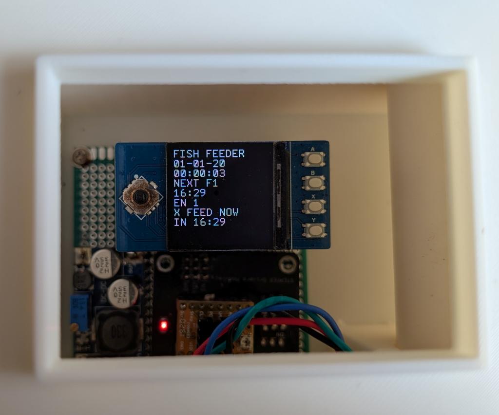

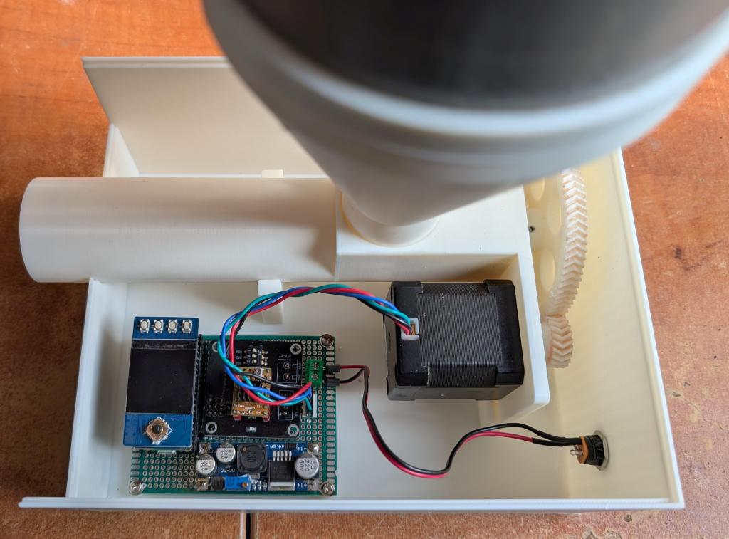

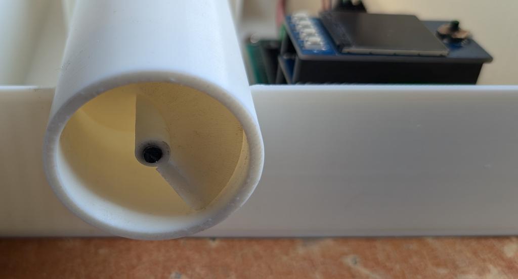

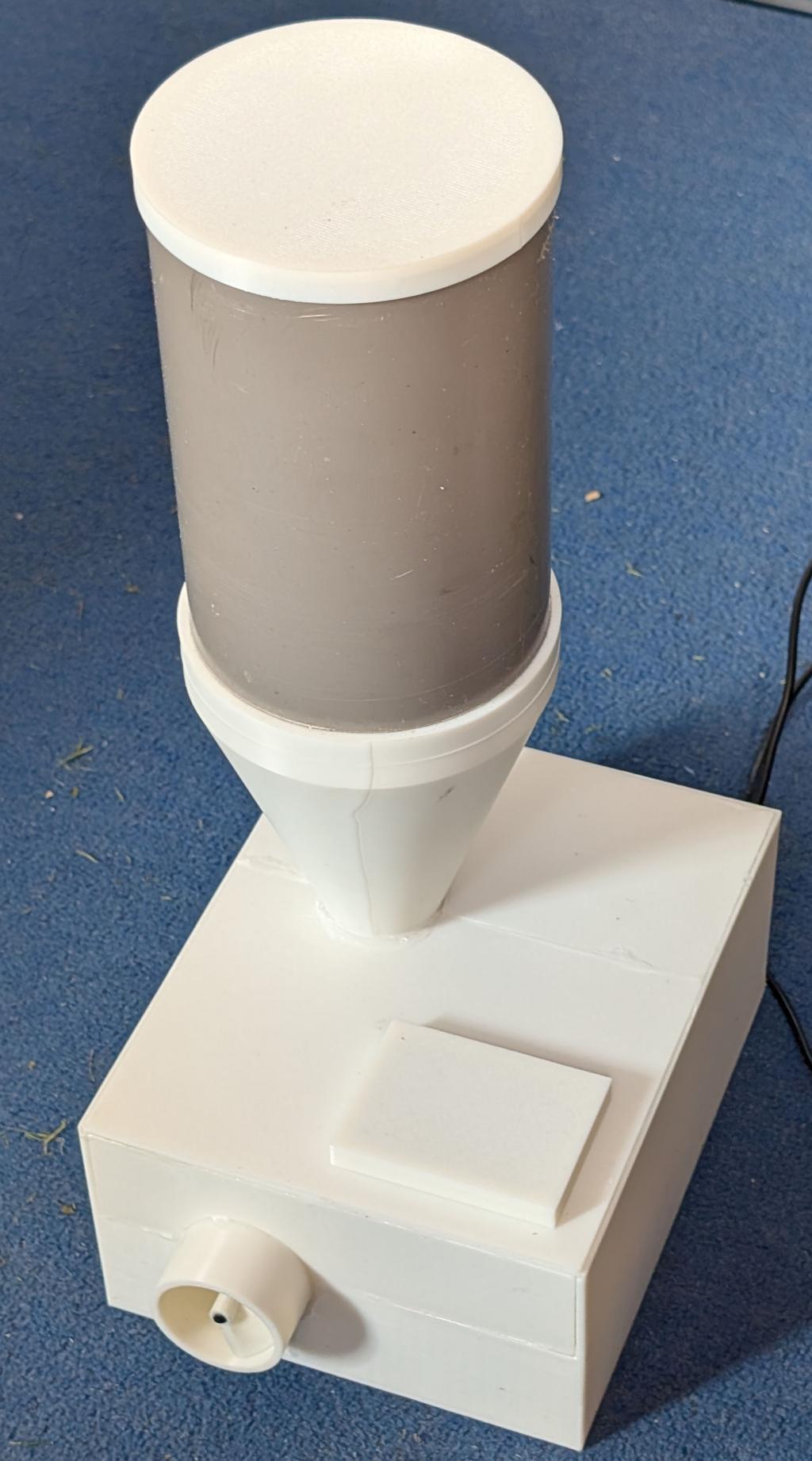

Pico2 + Waveshare RTC + Pico-LCD-1.3 + Stepper driver module + TMC2209 driver
Everything 3D printed. STLs available if anyone wants them. Uses archimedian screw to deliver the food.
Runs with a CPU speed of 48MHz which results in a current draw of about 25mA at 12V so an old car battery should run it for a month easily.
option list
PicoMite MMBasic RP2350A V6.02.01RC8
OPTION SYSTEM SPI GP10,GP11,GP28
OPTION SYSTEM I2C GP6,GP7
OPTION AUTORUN  ON
OPTION FLASH SIZE 4194304
OPTION COLOURCODE ON
OPTION CPUSPEED (KHz) 48000
OPTION DISPLAY 64, 132
OPTION LCDPANEL ST7789, LANDSCAPE,GP8,GP12,GP9,GP13

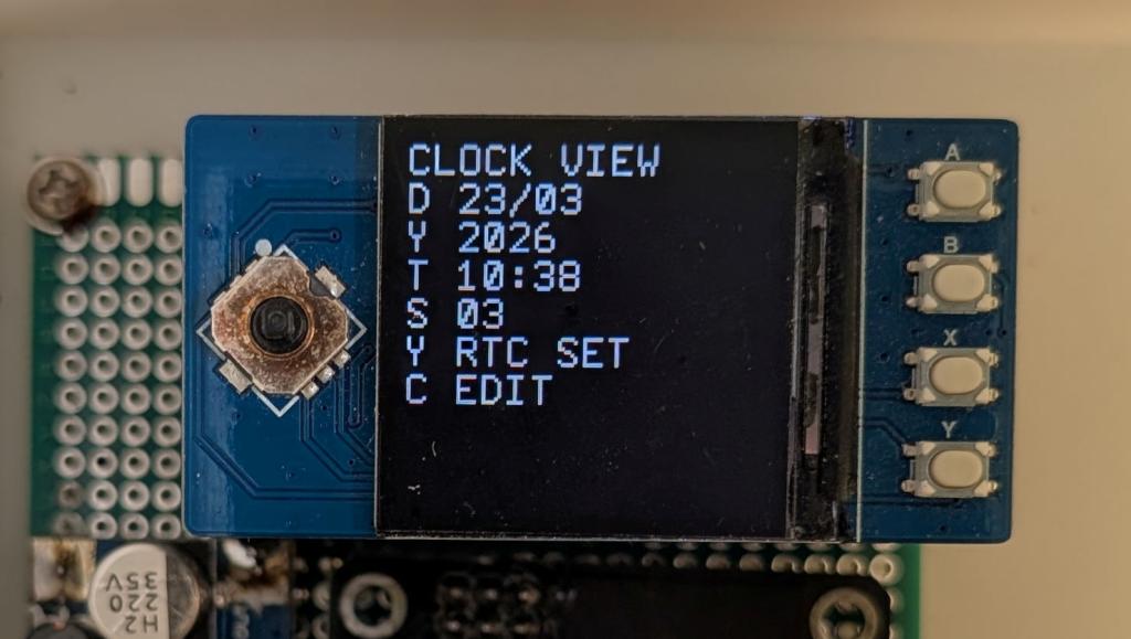

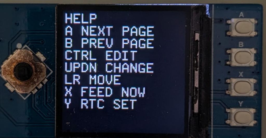

' FishFeeder.bas
' Automated fish feeder UI for PicoMite (240x240 display + buttons/joystick)
' Navigation:
' A = next page, B = previous page
' CTRL = toggle edit mode on current page
' UP/DOWN = change selected field/value in edit mode
' LEFT/RIGHT = move field selection in edit mode
' X = manual feed now (from HOME page)
' Y = force RTC SETTIME (from CLOCK page)
Option Explicit

Sub InitStepper
 Stepper Init
 Stepper Axis X, GP26, GP27, GP22, 1, 800, 100, 100
 Stepper Position X, 0.1
 Stepper Run 1
 Stepper gc g1 x0 f100
End Sub

 If page% = PAGE_CLOCK And ev% = EV_Y Then
   ApplyRtc
   Exit Sub
 End If

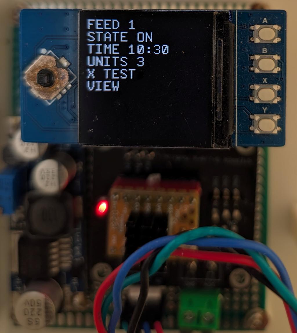

Sub EditFeed(idx%, ev%)
 If ev% = EV_LEFT And fieldSel% > 0 Then fieldSel% = fieldSel% - 1
 If ev% = EV_RIGHT And fieldSel% < 3 Then fieldSel% = fieldSel% + 1
 If ev% = EV_UP Then
   Select Case fieldSel%
     Case 0: feedEnabled%(idx%) = 1: scheduleDirty% = 1
     Case 1
       Inc feedHour%(idx%)
       If feedHour%(idx%) > 23 Then feedHour%(idx%) = 0
       scheduleDirty% = 1
     Case 2
       Inc feedMin%(idx%)
       If feedMin%(idx%) > 59 Then feedMin%(idx%) = 0
       scheduleDirty% = 1
     Case 3
       Inc feedUnits%(idx%)
       If feedUnits%(idx%) > 20 Then feedUnits%(idx%) = 20
       scheduleDirty% = 1
   End Select
 End If
 If ev% = EV_DOWN Then
     Case 0: feedEnabled%(idx%) = 0: scheduleDirty% = 1
     Case 1
       Inc feedHour%(idx%),-1
       If feedHour%(idx%) < 0 Then feedHour%(idx%) = 23
       scheduleDirty% = 1
     Case 2
       Inc feedMin%(idx%),-1
       If feedMin%(idx%) < 0 Then feedMin%(idx%) = 59
       scheduleDirty% = 1
     Case 3
       Inc feedUnits%(idx%),-1
       If feedUnits%(idx%) < 1 Then feedUnits%(idx%) = 1
       scheduleDirty% = 1
   End Select
 End If
End Sub
Sub ApplyRtc
 Local ys%, ms%, ds%, hs%, ns%, ss%
 ys% = setYear%
 ms% = setMonth%
 ds% = setDay%
 hs% = setHour%
 ns% = setMin%
 ss% = setSec%
 RTC SETTIME ys%, ms%, ds%, hs%, ns%, ss%
 Pause 50
 LoadClockIntoSetFields
End Sub
Sub LoadClockIntoSetFields
 Local d$, t$
 d$ = Date$
 t$ = Time$
 setDay% = Val(Mid$(d$, 1, 2))
 setMonth% = Val(Mid$(d$, 4, 2))
 setYear% = 2000 + Val(Right$(d$, 2))
 setHour% = Val(Mid$(t$, 1, 2))
 setMin% = Val(Mid$(t$, 4, 2))
 setSec% = Val(Mid$(t$, 7, 2))
End Sub

Sub ManualFeed
 Local idx%, i%
 idx% = 1
 If page% >= PAGE_FEED0 And page% <= PAGE_FEED_LAST Then
   idx% = page% - PAGE_FEED0 + 1
   DispenseUnits feedUnits%(idx%)
   Exit Sub
 End If
 For i% = 1 To FEED_MAX
   If feedEnabled%(i%) Then
     idx% = i%
     Exit For
   End If
 Next i%
 If idx% <= FEED_MAX And feedEnabled%(idx%) = 0 Then Exit Sub
End Sub
Sub DispenseUnits(units%)
 Local dist!
 If units% < 1 Then units% = 1
 dist! = units% * UNIT_MM
 Stepper GCODE G1, X, dist!, F, STEP_FEEDRATE
 Do While Peek(STEPPER ACTIVE)
End Sub

Sub DrawHelp
 Text 4, 4, "HELP"
 Text 4, 28, "A NEXT PAGE"
 Text 4, 52, "B PREV PAGE"
 Text 4, 76, "CTRL EDIT"
 Text 4, 100, "UPDN CHANGE"
 Text 4, 124, "LR MOVE"
 Text 4, 148, "X FEED NOW"
 Text 4, 172, "Y RTC SET"
End Sub

Sub DrawHome
 Local nexti%, i%, nowMins%, fm%, m%, t$
 Local dMins%, cH%, cM%
 t$ = Time$
 nowMins% = Val(Mid$(t$, 1, 2)) * 60 + Val(Mid$(t$, 4, 2))
 nexti% = 1
 fm% = 24 * 60 + 1
     m% = feedHour%(i%) * 60 + feedMin%(i%)
     If m% >= nowMins% And m% < fm% Then
       fm% = m%
       nexti% = i%
     End If
   End If
 Next i%
 If fm% = 24 * 60 + 1 Then
       fm% = feedHour%(i%) * 60 + feedMin%(i%)
       nexti% = i%
       Exit For
     End If
   Next i%
 End If
 Text 4, 4, "FISH FEEDER"
 Text 4, 28, Left$(Date$, 8)
 Text 4, 52, Left$(Time$, 8)
 Text 4, 76, "NEXT F" + Trim$(Str$(nexti%))
   Text 4, 100, "--:--"
   Text 4, 172, "IN --:--"
 Else
   Text 4, 100, TwoDigit$(feedHour%(nexti%)) + ":" + TwoDigit$(feedMin%(nexti%))
   dMins% = fm% - nowMins%
   If dMins% < 0 Then dMins% = dMins% + (24 * 60)
   cH% = dMins% \ 60
   cM% = dMins% Mod 60
   Text 4, 172, "IN " + TwoDigit$(cH%) + ":" + TwoDigit$(cM%)
 End If
 Text 4, 124, "EN " + Trim$(Str$(EnabledCount%()))
End Sub
Sub DrawClock
 Local m$, markX%
 markX% = 240 - (3 * MM.FONTWIDTH)
 If editMode% Then
   m$ = "EDIT"
 Else
   m$ = "VIEW"
 End If
 Text 4, 4, "CLOCK " + m$
 Text 4, 28, "D " + TwoDigit$(setDay%) + "/" + TwoDigit$(setMonth%)
 Text 4, 52, "Y " + Trim$(Str$(setYear%))
 Text 4, 76, "T " + TwoDigit$(setHour%) + ":" + TwoDigit$(setMin%)
 Text 4, 100, "S " + TwoDigit$(setSec%)
 Text 4, 124, "Y RTC SET"
 Text 4, 148, "C EDIT"
 If editMode% Then
     Case 0: Text markX%, 28, "<D"
     Case 1: Text markX%, 28, "<M"
     Case 2: Text markX%, 52, "<Y"
     Case 3: Text markX%, 76, "<H"
     Case 4: Text markX%, 76, "<N"
     Case 5: Text markX%, 100, "<S"
   End Select
 End If
End Sub
Sub DrawFeed(idx%)
 Local m$, en$, markX%
 If feedEnabled%(idx%) Then
   en$ = "ON"
 Else
   en$ = "OFF"
 End If
 If editMode% Then
   m$ = "EDIT"
 Else
   m$ = "VIEW"
 End If
 Text 4, 4, "FEED " + Trim$(Str$(idx%))
 Text 4, 28, "STATE " + en$
 Text 4, 52, "TIME " + TwoDigit$(feedHour%(idx%)) + ":" + TwoDigit$(feedMin%(idx%))
 Text 4, 76, "UNITS " + Trim$(Str$(feedUnits%(idx%)))
 Text 4, 100, "X TEST"
 Text 4, 124, m$
 If editMode% Then
     Case 0: Text markX%, 28, "<E"
     Case 1: Text markX%, 52, "<H"
     Case 2: Text markX%, 52, "<M"
     Case 3: Text markX%, 76, "<U"
   End Select
 End If
End Sub

Posted: 09:21pm 22 Mar 2026
Wonderful and really nicely engineered; I especially liked the "Citroen-style" herringbone gear system.  Just typical of Peter to use a complex (but appropriate) gear system instead of straight gears.  Lucky fish!
