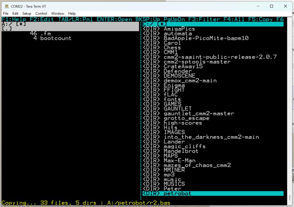

Posts: 12055
Posted: 05:30pm 14 Apr 2026
Attached is the HDMIUSB code if anyone wants to try it. Check the updated spec - lots more goodies now included. The key point about this is that is should be possible to work entirely within fm. There should be no reason ever to have to go the command prompt other than things like changing options.
PicoMite.zip
RP2350 PicoMite version (ashould work on PicoCalc)
PicoMite.zip

Posted: 07:41pm 14 Apr 2026
Hi Peter,
Should up/down arrow auto repeat when single line scrolling up/down through list of files, I realise maybe not once you get to top/bottom of screen because of the slow refresh, but when scrolling through a list that is wholey on screen would be nice, I'm using a USB keyboard.
If I load a program with F2, then make some trivial change and run it with F2 the Pico locks up, needs a reset.
Otherwise looking very nice, works in all the resolutions I've tried, haven't tried most of the features yet.
Kevin.
