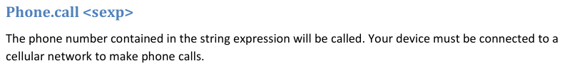

PhenixRising
Joined: 07/11/2023
Posts: 2100
Posted: 08:25am 29 Apr 2026
Just an FYI re: phone app.
I believe that the following is true but I'll check when I get to my desk.
Google has tightened-up "security" and therefore, they prohibit dialling and texting apps on PLAY, including the programming languages that facilitate this.
I use RFO-BASIC (interpreter) for Android and if I want to incorporate dialling/texting in my app, I need to download the unrestricted version of the language directly from them. My app would not be allowed in PLAY which doesn't bother me. The language is a doddle to use. I'll update after I have a play, later on. 👍
PhenixRising
Joined: 07/11/2023
Posts: 2100
Posted: 10:34am 29 Apr 2026
This will call the number (string expression) without showing the number on the screen (keeps it hidden)
RFO-Basic Manual 1.91 De_Re_BASIC!.pdf

PhenixRising
Joined: 07/11/2023
Posts: 2100
Posted: 03:06pm 30 Apr 2026
  PhenixRising said  This will call the number (string expression) without showing the number on the screen (keeps it hidden)
Graeme,
I just tested this on a later edition of Android (to see if Google had crippled it) and sure enough, that simple one line is all that's required:
Phone.call "1234567890"
Type this is in the editor (with a valid number), on the Android device and select RUN from the menu. The number dials
The bit about the number being hidden is not true, though. It shows. However, there are all kinds of tricks available in this language and I would expect that disabling this would be doable.
I installed the Basic_191.apk
Further info: What about creating an app that can be distributed?
There is a compiler that runs on the device. It creates a ".apk". This is not really compiled, the code is still interpreted. It's actually a "packager". The end-user sees it as any other apk file.
Edited 2026-05-01 01:12 by PhenixRising
