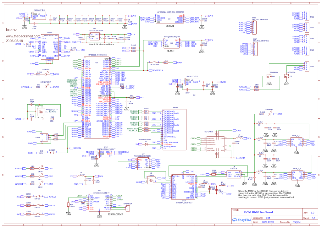

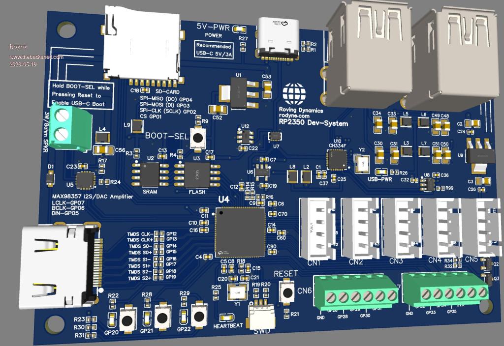

I would not trust vibe auto-routing (yet) on a part like the RP2350, too many gotchas in the design guidelines which could make the board unreliable or unusable. Vibe-auto-routing will probably work eventually, but let somebody else beta-test it.
I actually finished a design of a new RP2350B board in EasyEDA last week for a home project; I too did not use the internal 1.1V switched regulator for vCore, it was far simpler to use a 300mW 1.2V LDO linear reg, which costs less than the specified inductor, allows for more reliable over-clocking and easier routing. Unfortunately I have been reluctant to push the JLPCB Buy now button as the cost is US$118 for 2 assembled boards, and once I add in the courier charges to NZ and the US$ exchange rate it gets a bit expensive
Files here if anyone interested: EasyEDA project zip and circuit image

  boznz said  Files here if anyone interested:
Could you provide a pic?
Sorry, schematic was in the linked zip file, but here's the images for those without EasyEDA accounts. I doubt you could auto-route this easily in 2 layers, it is not a difficult design to manually route though, and the Raspberry Pi design guide is quite helpful. The only thing different on this board from the usual ones is the inclusion of an I2S amplifier and a logic latch to automatically switch the USB port between the hub and the USB3 port. I will get around to pushing the buy button eventually
