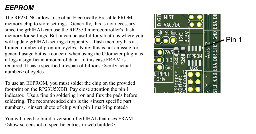

Posted: 11:23am 13 Jul 2026
Great timing because I was just thinking about FRAM since I saw it on a grblHAL board.
Mikroe has a FRAM Click module
Oh, I see there are both SPI and I2C versions.
Edited 2026-07-13 21:26 by PhenixRising
