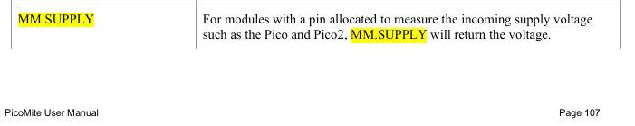

It's in the manual MM.SUPPLY

Posts: 11727
Posted: 08:32am 08 Aug 2026
  Quote  For modules with a pin allocated to measure the incoming supply voltage
such as the Pico and Pico2, MM.SUPPLY will return the voltage.
