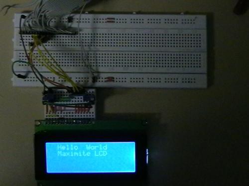

Found / Tested source of low cost 20 x 4 backlit LCD. When ordered cost me AU$9.58 inc shipping - see price slightly increased today.
9 days from ordering from HongKong to Perth - received it today through Aussie Post
Example of James Code Running on the display attached
http://cgi.ebay.com/HD44780-20X4-Character-LCD-Display-BLUE- backlight-1-pcs-/380349890122?_trksid=p4340.m263&
picture attached2011-07-13_223227_20x4_LCD_on_MM.pdf
RayB from Perth WA

Thanks for the picture ... it really does paint a thousand words ... particularly the way you have done the pins for the ribbon cable and the printing of the pin outs.
Good work on the LCD too. I'm keen to get get one working with the MM embedded version.
Keith

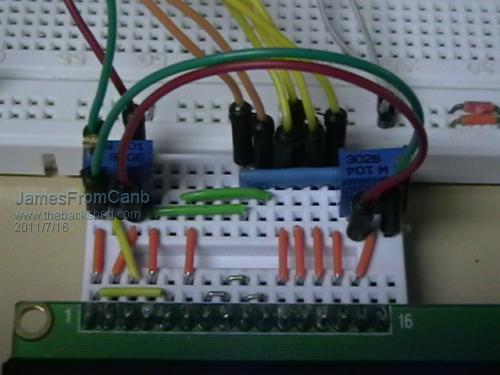

I now have a 17 x 10 prototype board. I think it's supposed to be for Arduinos, but it does a good job of supporting a 16 pin LCD screen. It was an interesting Saturday afternoon project to fit it all in - and I still had one row left over!
I did my MM to prototype board connection differently to Ray. I put the pins in order. The cable split is messier, but less confusing for me.
Here's a photo of the whole system
and one of the prototype board.
I particularly like the 10K Resistor Network which has 6 x 10K resistors in one unit. It's the flat blue unit in front of all the yellow and brown cables. That made life a lot easier.
I'm really starting to enjoy this. 10/10 for the Maximite!
