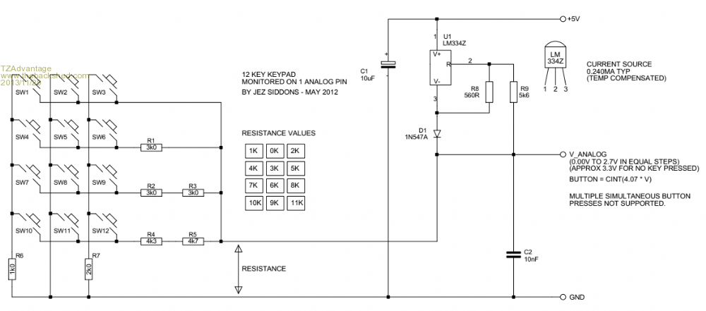

Jez Siddons, a member of the KSD forum, posted a project on the KSD forum about a 4x3 Keypad, on 1 analog input pin, that has created a bit on interest, and is very easy to implement.

I have used it before and it works great when the temperature is within a certain range.
When resistors get warm or cold they slightly change the voltage on the analog input.
For me it was not useful because of that.

Ahh.. There is a trick to that.
Rather than work with absolutes this is what I did in my code
If X >= 14 or X <= 18 then ' Check for 16
KeyValue = '1'
End If
If X >= 22 or X <= 27 then ' Check for 25
KeyValue = '2'
End If
That way you compensate for temperatures and minor voltage fluctuations

I had some trouble with it.
I tried the range, but they overlapped.
the temperature range i tested was between -20C (freezer) and 50C (in the sun).
Maybe a temperature sensor to compensate. :)
Or i had a not so good LM334Z.

Although I have never had that problem what you could do is this.
Add a Temp Sensor to the circuit and read that every so often.
Set up a standard resistor on the A/D and read it over a wide temp range.
Check several other resistors to see how they react.
This should give you an approximation on wether to add or subtract a temperature variance to the A/D read voltage,
i.e.
Gosub CheckTemp ' Return Temp Factor as TF being numerical
ReadAD Keyboard, KValue ' Get the value from the keyboard
KValue = KValue + TF ' add the temperature compensation
' All other code for decoding values to keys here

Has anyone got the original schematic for the 4 x 3 to 1 wire adc? The links are not responding and I really need this keypad platform to work.

Posted: 05:54am 29 Nov 2013
Here you go:

I have been trying for ages to get a reliable 1 wire set up for this keypad, but all I came up with was the resistor matrix, and how people found it to be reliable, I always found it to be the opposite, especially when the high number keys are pressed, the voltage steps just came so close to each other, rendering it unreliable. This set up looks perfect, okay, it has a few more components, costs a few more pence, but if it is reliable, so what.

I found the conversion to integer in the program line:
keynum=Cint(5.2539*vkey+0.0534) (constants depend on calibration)
was the best (and simplest) way to reliably convert voltage to key because it automatically gives the full +/- range for each key's voltage. Also, the supply has to be 5v to give the full 3.3v range across the keys without putting greater than the allowable 3.3v on the analog input. The "no key pressed" condition is the highest voltage and is just less than 3.3v.

Sparkfun now sells VKey Voltage Keypad 3x4 as part PRT-12080. It uses a constant current source and user comments discuss temperature effects.

I have used this idea on a PICAXE, but not the uM chip or any other platform. It was at the PICAXE forums, that the idea was discussed for that platform, but it is essentially the same, from what I can see, the only difference being that in the PICAXE version, there was not current-source used, but that is a good idea.
As the diagram itself says, does not support multipule simultaneous presses, but I was using it for a simple code-lock at home, and it seemed to work just fine for that.
Any keypress not in the right place in the sequence, would reset the code lock to the beginning. In my case, I used a PICAXE 08M 8-pin DIL chip, and the code was 6-digits long, with piezo beeper for each keypress, relay output and LED's.
In all the time I used it, I never had any issues with buttons not working due to temperature variations, as mentioned by TZA, but that must be possible, or he would not have posted about it. I used 1% metal film resistors for accuracy, and I think they are a bit more temperature stable then carbon film ones - not exactly sure.
I used exactly the same idea for finding the key:
