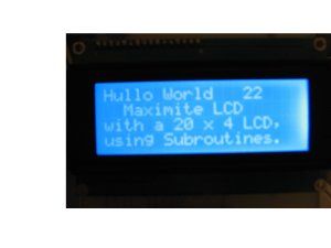

Has anyone used the LCD drivers for the maximite, the ones in the basic library on Geoff Grahams site.
Both sets of lcd software work but how does one add information to a line to be displayed.
Printing a text string to the LCD works fine but how do I add a variable ie..
"The temperature is.." variable.
Do I have to convert everything to asc and then send the lot as one string.
Any suggestions welcome.

Correct syntax is to use the Str$ function (page 28 of the Manual) to convert the numeric value of the variable into a string representation and concatenate (join) to the end of text message.
"the temperature is .."+STR$(Variable)
an example using the LCD routine is
PrintLCD 1,"Current Ambient temp is "+STR$(Ambient_temp)Edited by djuqa 2012-05-13

Thanks djuqa
That works fine, I new if I asked I would be put on the right track.

Another option to display it would be:
PrintLCD 1,"Current Ambient temp is " + format$(Ambient_temp, "%+7.2f")
This will give a + or - symbol and the temperature with 2 digit precision
and alignment all in one. :)
The alignment and width is important if it has to be aligned with other values on the display. Adding a ; to the end of that line will allow you to display more info on the same line with the next PrintLCD command, like it is now the cursor will go to the start of the next line
* I am not sure if PrintLCD works exactly the same as Print with the ; at the end.
Maybe you can test that and report back.

Here is a picture of a 4X20 lcd using the subroutines from the Maximite site, the 22 to the right on the screen is where I was putting the temperature from the information in the previous posts.
Once the lcd is initialised the print routine can be called from anywhere within the program.
very happy.
