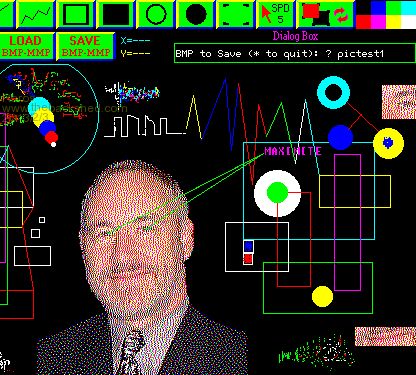

For fun i did this graphics program, Micro MMPaint for Maximite Color using a serial mouse.

Is not yet complete!
I should add error checking for working with the sd-card, add text at graphics,
file management with visualization of the directory in combination with a menu
activated with the right mouse button for operations such as info, rename,
load and kill, using sprites (I already did some tests and it's great).
Fill areas of the screen with a color I have no idea how to do......
However, it is usable.

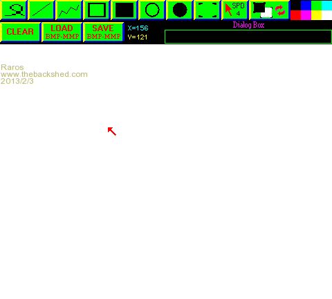

The menu button is fairly intuitive.
Button top-left: Free design (default).
Line and multi-line in mode sequentially.
Boxes and boxes filled.
Circle and filled circle.

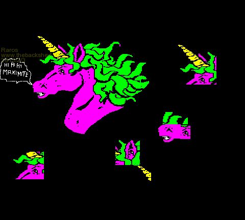

BLIT copy portions of the screen with preview.
Mouse speed.
Swap the color of the Foreground and Background.
Choosing the color of the Foreground.
The second set of buttons is:
Clear screen with the background set.
Load and Save BMP.
The format MMP saves and loads portions of the screen with PEEK and POKE:
Header:
4 bytes "MMP" + 1 free byte.
4 bytes X and Y coordinates initial
2-byte length (maxlenght = 480/8 * 369 lines useful = 22,140)
Image:
xx bytes in the following sequence:
3R-3G-3B-2R-2G-2B-1R-1G-1B-0R-0G-0B-7R-7G-7B-6R-6G... ...59R-59G-59B-58R-58G-58B-57R-57G-57B-56R-56G-56B
First line of pixel RGB etc.
Read from the buffer video is easy. Example:
Open "file.mmp" For output As #2
For t = 0 To Lenght
Print #2,Chr$(Peek(RVIDEO,t));Chr$(Peek(GVIDEO,t));Chr$(Peek(BVIDE O,t));
Next t
Close 2
End
For the time being suspended due to a small bug (PEEK) and The Big Geoff fix in the next release.

With Load BMP can be specified with the mouse the coordinates of loading.
The X and Y coordinates
Finally, the 'Dialog Box' indicates the operations to be done.
At any time you can abort any command by clicking anywhere on the menu.
