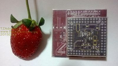

I am as good as finished with designing the smallest ever Colour Maximite clone.
I made a paper mock-up to be able to use it for measuring and fitting enclosures.
My 3d printer is still a few weeks away, so the designs are in my head and a few tests in Sketchup.
Just to get an idea of the size i made a picture of the mock-up next to a strawberry. :)
btw. Nanomite is just my 'working name' for this project.
The red board holds the connectors. It has:
Micro USB
USB-A for a keyboard (Still has to be PS/2 compatible)
MicroSD
IO with PIN1 to 20 and 5v,3.3v + Gnd
2 joystick connectors with 5 digital and 2 analog pins.
Colour VGA header
Sound connector
Reset, Bootloader, Composite video selector, USB power jumper headers.
Battery for the onboard RTC.
Dual colour LED for Power and SD activity.
5-24v power supply (this is still in test and only when it fits)
The black board holds:
PIC32MX795L
8Mhz crystal
Optional 32Khz crystal
3.3v regulator
Supervisory chip (For having well defined startup resets and brownout handling)
Led power indicator
And of course lots of decoupling capacitors.
I have seen some very LARGE strawberries in my time.
Great work TZ.
Hi TZ, I think that strawberry looks a bit shrunken so that makes you work even more impressive, well done! Maybe you have created a "StrawberryMite" - apologies to RaspberryPi of course!
