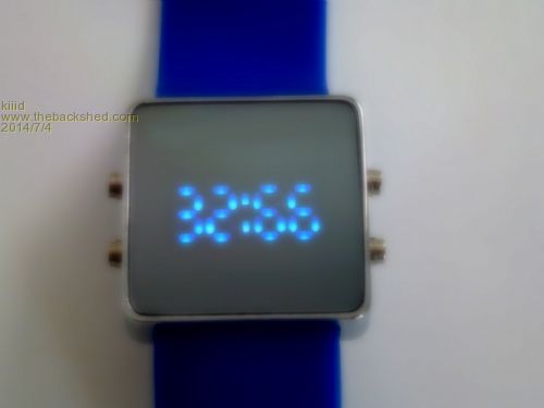

Posted: 05:55pm 03 Jul 2014
  Talbit said
Back to GPS. I think the world should all run off UTC and use decimal clocks!
Talbit
The thread is old indeed but I just noticed this post by Talbit. I think I can help you out with that as it falls within my interests too. Check this out.
I have even made a wristwatch and a rock-solid algorithm to use a standard 32.768kHz crystal (that in C but I can still publish it if anyone is interested). It can be easily adapted to UTC input as well.
An experiment with my two young kids showed that they are much more susceptible to decimal time in comparison to what we use now.
I am curious to find out is there any other 'crazy' people in the world, who are interested in decimal time?
http://rittle.org

Posted: 08:40pm 03 Jul 2014
For a long time I have thought about decimal time, seems you have worked it out very well Kon, but I think it would be a very brave government that would even consider such a change.
Paul.
