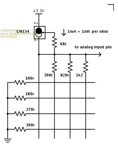

for those struggling to work with both LCD and KEYBOARD at the same time with a micromite, the following solution might be of use to get back 7 pins. it uses a single analog input pin to read the keypress from a keyboard set up to provide a 16-level analog output:
the LM334 with 68 ohm resistor will give a 1mA current flow through the keyboard when a key is pressed. the other resistor values have been chosen such that the output voltage (1mV per ohm) will range between 100mV for the top left key up to around 1.6v for the bottom right key. unfortunately the steps are not perfectly even, so it will be necessary to use 15 if/then statements to sort out the keys. the resistance/mV values returned should be close to:
100, 490, 920, 1300,
180, 570, 1000, 1380,
270, 660, 1090, 1470,
390, 780, 1210, 1590
software required is a 5mS (or thereabouts) timer interrupt routine that reads the analog pin, and if it is within around 30mV of the value read on the previous interrupt, deposits the read voltage into a variable. this double-check will act as a debounce mechanism. the A/D converter in the micromite (set up for 3.3v FSD) should be able to resolve down to around the 3mV level.
the main program, when wanting to check for a key needs to first see if the ISR returned voltage was greater than about 2 volts - if so, then no key was pressed. it then needs a series if/then statements to separate out the above 16 voltages. the split points will be the differences between consecutive values:
0.140v, 0.225v, 0.330v, 0.440v, 0.530v,
0.615v, 0.720v, 0.850v, 0.960v, 1.045v,
1.150v, 1.255v, 1.340v, 1.425v, 1.530v (please check, i calculated these by hand)
use 1% resistors. the 68 ohm resistor could be replaced by a 100 ohm/20 turn pot, which would allow tweaking the spread of the whole range. but this would probably be overkill. the top two voltages (1.47v and 1.59v) are about 8% apart, which is much greater than the tolerance stackup of everything else. the above circuit and code has not been tested, but i see no good reason why it should not work.

The analogue input method has been covered on the forum a couple of times before, e.g. 4x4 keypad single input.
There's no real issue with the number of pins available, it's more to do with sorting out the two interrupts operating concurrently i.e. from SETTICK for the countdown, and keypresses from the new KEYPAD command. It's working OK at the moment, but it's not tidy.

have built up the above circuit, and it works well. needed the one addition of a 100k resistor from the input pin to ground. this kept the micromite happy, as it did not like to see it's input floating high. the error introduced into the calculated voltage drops by this resistor is negligible.
below is sample code. debounced, and ignores multiple buttons pressed at once. have not been able to fault it:

note the two constants 0.018 and 1.06 in the ISR. the 0.018 is the resistance of the keypad i am using. seems to be fairly constant. adjust so that when the '1' key is pressed keyvolt is 0.100 or thereabouts. the 1.06 multiplier is to take account of the inaccuracy of the 3v3 on my setup. again, adjust so that the bottom right key returns a keyvolt of close to 1.59

The circuit shown in the link I gave above gives a gives an almost 100% linear response to the keys. you can then replace the seventeen IF statements of your code with one line, (as for linear equations (y = S*x + c)):
keynum=Cint(5.2539*vkey+0.0534) 'Convert to integer by calib'n eqn

it seems that with the 28-pin micromite there is a major issue if one wants to use both a keypad and an LCD using the built-in commands and minimal extra hardware. of the 19 available pins, 14 are used up, leaving just 5 free! add an RTC, and you are now down to only 3.
you are right, that a linear solution is possible, but the original circuit still has a few issues. from my own testing, it will not work reliably with the micromite due to the analog input being left floating when no key is pressed (an easy fix), plus it does need a 5v supply to operate with the choice of resistors and temperature compensation of the LM334. upping the current to 1mA and dropping the TC allows for 3v3 operation and better noise immunity. the TC is nice, but adds complexity that most beginners don't need. does anyone know of a better choice than an LM334?
having done a few more calculations, one can use 4x 100 ohm resistors in a ladder for the rows, and 3x 390 ohm resistors similarly for the columns, with a 220k resistor to keep the LM334 live when all buttons are open. the key voltage then becomes 100mV (+18mV for keyboard resistance), plus 97mV per step. the (calculated) returned resistance stays within about a 2% error band.

apart from the cost, the LT3092 doesn't come in a leaded package. if it did (and was cheaper and more widely available) it would be quite perfect.
doing a few calculations, i see that going from 0 to 50 degrees C the voltage 'output' of the LM334 varies between about 62mV and 74mV. this translates to an output current (with 68 ohm resistor) going from 0.91mA to 1.09mA, so temperature compensation is pretty much essential in any application outside of the lab.
adding in the 0.6v drop of the compensation diode necessitates running off 5v, unless someone can come up with a better compensation mechanism that doesn't incur any additional voltage drop. my thoughts are:
1. if the internal temperature sensor of the micromite could be read, this could be used to make a correction at the calculation stage. there is still the issue of the A/D converter being scaled to the Vcc voltage.
2. adding in just the right PTC thermistor across the current setting resistor so that the combined value tracks from 62r up to 74r over the 0 to 50 degrees C range.
3. a second LM334/68r resistor could feed a fixed 1k6 resistor monitored by a second analog input - this could be used to derive a scaling factor. advantage - this would also compensate for Vcc not being 3v3.
