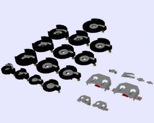

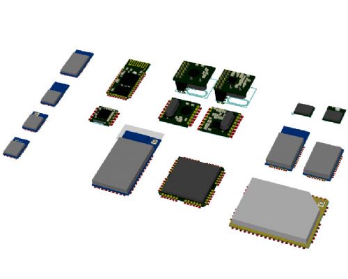

I used to check this source once in a while, but I forgot to do it for some time by now and I had a nice surprise today. A lot of new components in every area of interest. Some pictures:
Battery holders, recently discussed on forum:
Some RF modules

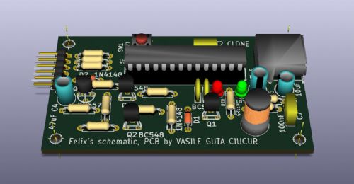

There is also an improved 3D renderer for the PCB (and a python scripting console, ready for programming additional tools):
Components are from the link above.
