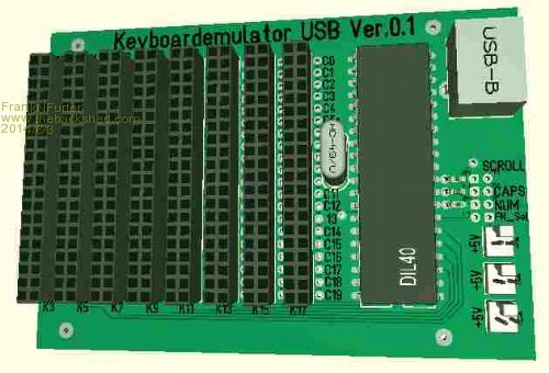

I've built a little circuit for my Raspberry Pi projekt.
It uses a normal keyboard-chip HT82K629A from Farnell for 1,77 € and you can emulate any button of a normal keyboard.
I use it for joystick and buttons in my projekt above...
You can plug any push-button on the matrix to generate any key and it works very fine!
It works with any PC, Rasperry Pi AND WITH THE MAXIMITE with an PS/2-adaptor.
If anybody is interested on it, I can send the PCB data or I can maybe convert my fileformat to Eagle...

I used to hack keyboards whenever I needed to do something like this, but this would definitely be the way to do it. I actually have about 10 of those KB chips, but my first attempt to get it working failed, so I never went back to them.
Can you post the PCB files here as a ZIP perhaps?

Hi Grogster,
which PCB format did you prefer? Gerber? There is a little mistake in my actual design (C18 is mixed with C19). I can post it in a few days...
There are different datasheets on the web. I merged the relevant things from the datasheets in one design...

Grogster is right! I tried my circuit with a Duinomite and a PS/2 to USB adaptor - it works very well!
You can wire a PS/2 cable direct on the PCB instead of the USB jack...

According to Holtek, the HT82K629A chip has USB/PS2 auto-sensing - so you can just solder a PS/2 connector instead of the USB one.
http://www.holtek.com/english/docum/computer/82k629a.htm
Pin17 is USBD+ & PS2 CLK
Pin18 is USBD- & PS2 DATA

Ok, here are the files...
Enjoy it!
2014-06-05_064047_Keyboardemulator-USB_V0.2_140605_Circuit.p df
2014-06-05_064115_Keyboardemulator-USB_V0.2_140605Layout.pdf
2014-06-05_064135_Gerber.zip
Frank

I ordered my PCB from a little shop in Germany and drilled it by hand (I re-invented the breadboard - my system says there are 560 holes) within 1 1/2 hour!
The shop can't make vias - thats the ground why all components are soldered on the bottom and rivets (correct word?) are set for connecting...
