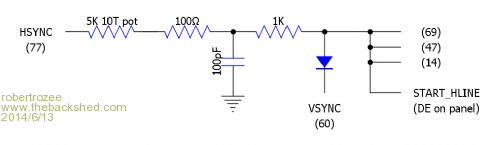

I have a TFT-Maximite rev. 1.3 bought at segor.de. The Maximite itself works fine, but I have a problem with the display: If the supply voltage is slightly below 5V (at about 4.5 to 4.6 V) everything is ok. If it is about 5V the screen content is jumping erratically (every 0.5 to 5 sec.) down by exactly one line.
segor has a page that describes a bugfix for some sort of image jittering (http://www.segor.de/#/bauteilesaetze-a-module/bauteilesaetz e/ct-tft-maximite). According to Carsten Meyer this bugfix should solve my problem.
He was right, it worked, but unfortunatelly not as I hoped it would. The screen content is not jumping anymore one line down erratically, now it is shifted permanently one line down so that the last line is not displayed.
I tried to contact Mr. Meyer again but didn't get any answer until now.
I don't know much about video signals, but I guess that the slope of the sync-signals is too slow now so that the synchronisation is not working correctly anymore. I replaced the additional 1k resitor with a small potentiometer and after some fiddling with the two potentiometers I got a stable and complete image.
It's working now, but I still have some questions:
- Is this a common problem or am I the only one affected?
- Is my guess with the additional resistor right, is it messing with the signal slope?
- Would it be better to reduce C6 instead of adding a resistor?
- Is this a problem of the display (manufaturing tolerances) or a problem of the controlling circuit (the TFT-maximite)?

After a bit of searching I found the "bug fix". This is Google's poor translation of it:
  Quote  Jitter at different positions of the balance controller:
Some customers / users have a tremor of the image faulted, the cause is too large capacitive load on the vsync pins through the 100 pF capacitor C6. This effect can be removed by a small modification, it requires only one additional resistor with a value of 1k ohms.
First, C6 (100 pF) unsoldered and soldered me only one pin to ground again. Resistor R19 (100 ohms) is also desoldered and then with only one pin at the pad, which is connected to the trimmer R6 soldered. At the other (free) pad of the 100 ohm resistor of 1K ohm resistor is soldered extra with a pin now. The two free ends of the resistors and the capacitor (C6) are connected to each other (for example, a wire). Now the trimmer for the phase shift works as usual, but is decoupled with the added resistance of 1 kOhm from the VSync signal. The horizontal phase can then be matched to the Vertikalsyncronisation without influence.
This is a hardware issue caused by the circuit (designed by Carsten Meyer) used to delay the sync pulse. There is not much that can be done to improve the issue because the circuit used is so simple - as you say, it is "messing with the signal slope". So your trick of replacing the resistor with a trimpot is probably the best solution but the exact fix will vary with different LCDs.
Geoff

the sync pulse 'delay' circuit looks all wrong. as far as i can tell, this is what is implemented, which actually does several things:
firstly, it messes with the maximite's operation. normally pins 14, 47, 69, and 77 are linked together, and provide the horizontal sync (HSYNC) output to the VGA monitor. the circuit breaks the link from pin 77 and (1) inserts a delay, and, (2) gates the signal feeding back into pins 14, 47, and 69 with the vertical sync (VSINC) signal.
secondly, and more importantly for the TFT panel, is that the delayed and gated pulse, now called START_HSYNC is fed into the DE input of the panel. DE is 'data enable', and is a signal that is required to be active only while valid video data is present on the Rn,Gn,Bn lines. as i recall from testing work i did with these panels a few years back (covered by NDA) the DE line needs to go active some number of HSYNC pulses after each VSYNC pulse. the exact number is specified in the data sheet for the panel, and varies by model. it may also require to be active only during the portion of the line that contains valid pixel data.
without the DE signal, the panel will display nothing, as i recall. this was, remember, a few years back, and so i am a little fuzzy. i was doing the hardware, another engineer handling the software. we derived out DE signal internally to our controlling device and adjusted it for each panel being tested.
the first problem that i can see with this circuit is that of delaying the signal that is sent back into the 32MX695. in the above diagram, pins 14,47, and 69 should be connected to HSYNC rather than START_HLINE. i guess Geoff is the best person to comment on the effect of this.
the second problem is that the DE generated is just, well, all wrong. really it should be generated from a counter running off HSYNC, with the counter reset by VSYNC; the output then being active when the count is > n, where n is an adjustable line number. it may also require to be further gated on and off during each line.
these may well be functions that MMbasic firmware could best generate itself, or certainly assist with. my suspicion is that the designer wished to be able to use MMbasic unaltered.
rob :-)

I don't have all the documentation with me but from memory the LCD panel needed the start of the video to be delayed compared to normal VGA. Pins 14, 47 and 69 are the framing inputs to the three SPI channels (red/blue/green) and they prevent the SPI channels from starting while they are low. By delaying the rising edge of this signal the start of the video was delayed.
There are probably many more robust ways of achieving this but we have the benefit of hindsight. At the time using a simple RC delay probably seemed "good enough".

it certainly provides some clues about why behaviour can be dependant on supply voltage - if the 3v3 line is marginal at 5v supply coming into the board, then the 0/1 threshold levels will change with supply and hence the timing. plus the delay circuitry assumes that both 32MX695 and LCD panel both have exactly the same thresholds. just a theory.
off the top of my head, the 32MX695 has four SPI channels, yes? so one could switch to an alternative approach: use the 4th SPI channel to generate DE from a 4th plane of video data. the data for this channel could always come from flash, or at least from a single line of data held in RAM - there would be no need to increment any line counter as every 'line' would be identical.
then implement the vertical blanking part of DE purely in the MMbasic firmware - simply turn the 4th channel on/off at the appropriate starting and ending video line numbers (using the line counter used for the other 3 R/G/B planes).
as for the need to delay the R/G/B data, increase the length (in pixels) of the video lines and always make the first n pixels black. or accept a lesser horizontal number of pixels without needing to introduce a delay.
it does seem that the role of the DE signal is being a little underestimated by all - it defines the 'window' of video data that put up on the LCD panel, and so is quite vital.
would this work?

I did some meassurments:
- Between 1000 and 350 Ohms the last line is allways missing but theres no jitter.
- Between 350 and 20 Ohms it is possible to get a clean image by adjusting the h-sync potentiometer, but if the supply voltage is changing the last line can vanish or jittering may occure, so it can be necessary to readjust h-sync.
- Below 20 Ohms the image is jittering.
At around 50 Ohms I got a permanently clean image, even for different supply voltages (down to 4.5V and below) without readjusting h-sync. So 1k Ohm is definitly too much, at least for my TFT-Maximite.
  Geoffg said  There are probably many more robust ways of achieving this but we have the benefit of hindsight. At the time using a simple RC delay probably seemed "good enough".
And (with a little bit of tweaking) it's working fine, so it can't be that bad. The simple solutions are often the best. And besides, afterwards you always know better.
Michael
