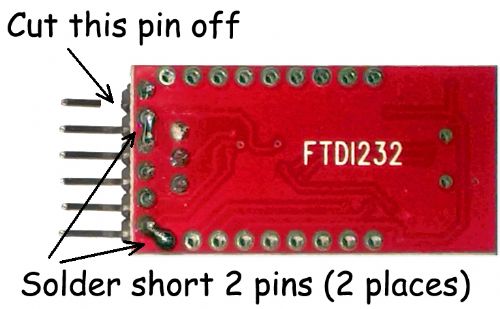

Lads,
I have come across a cheap (very cheap) USB to TTL serial converter that could be useful for projects such as MuP Ver. 2.
It is available from a Chinese company (and no doubt others of the same ilk) called, of all names BANGGOOD.COM for $4.34 each including postage.
The link to it is here USB-TTL Module
Now, as has been mentioned before there appears to be many fake FT232RL chips out there and to date almost all of the cheap Chinese companies have been guilty of using these. They generally have a date code of 1213 printed (not laser etched) and wont work with the latest FTDI drivers (Ver 2.10.0.0 27-Jan-14).
These BG units have a date code of 1313 (strangely 1 year exactly later than the known fake chips) and are laser etched not printed onto the surface of the chip.
The big plus is that they work fine with the latest FTDI drivers, I was not able to get the module to fail as I have with a known fake FTDI cable that I have.
I am NOT saying these are genuine chips but I am saying that the modules seem to work flawlessly.
I did do some current drain measurements with a module that reads only to 10mA resolution and the BG unit draw a fairly consistent 30mA whilst Phil's WhiteWizard module using a known genuine source of FTDI chips draws 10mA with fluctuations that flicker to 20mA both of these measurements are fairly stable and measured at idle (just powered up and not working serially).
Examining the BG unit is is obvious that it is MASS Produced and not NASA grade quality. Unlike the WhiteWizard module which is of an extremely high build quality and will work `right out of the box'
Why Post all this here? Well If you decide that you are prepared to give these BG modules a go they are dirt cheap and only require minimal (2 solder shorts and one cut pin) to plug straight into J12 of the MuP Ver. 2 board.
Bottom line I believe these `may' be a new brand of `fake' FT232RL chip that seems to work with all FTDI software drivers upto and including the latest version and these may be (or may not be) rendered inoperable, if they are fake, with a later driver release, you can always roll back to an earlier driver if that ever occurs.
If you wish to do further reading on the known fakes have a look at this article:
Hack-a-Day

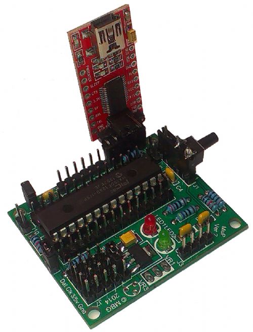

Details below:
and
EDIT***
If you do wish to use this with MuP Ver. 2 then configure the BG module to 5v (jumper on the module) and make sure you remove J9 on MuP.
Also it would be better if you fitted MuP with a Right angle Female header so that the BG module would sit horizontally rather than vertically (or replace the pins on the BG module with straight ones.

John,
That it is but it is a different pin-out than the BG one. What I liked about the BG one was the simplicity of adapting it to fit MuP Ver. 2 footprint.
Yours might be similarly adapted but I haven't yet looked at what you would need to do to accomplish that.
