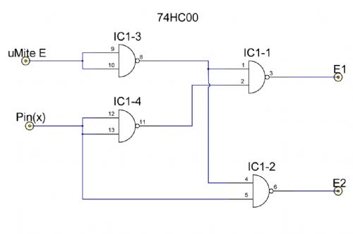

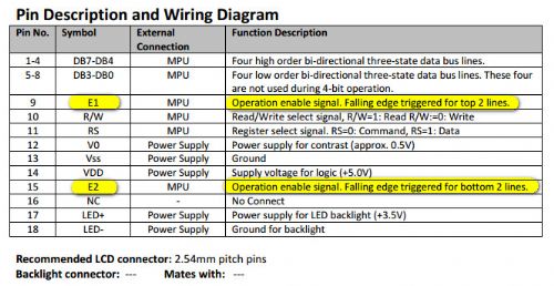

Hi all, trying to implement a 4004 lcd display. Here is the link
This display looks like it would work using uMite LCD feature, however the top 2 lines are controlled using E1, which is fine, however the bottom two lines use E2 for enable. Is there a way to implement this using maybe an extra output pin and after the first 80 characters are written, the E2 can be enabled and the balance can be written? Maybe an external logic gate or something?

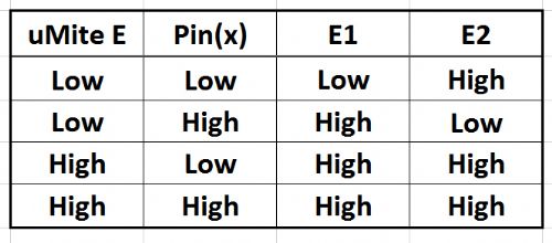

You could use a 74HC00 as shown and get what you want with one chip. and use one uMite pin (low for E1 and High for E2, just before you issue the LCD command)
Truth Table
Of course pin14 of the 74HC00 goes to Vcc and 7 to GND
PS. Thanks for making me remember the `good old days' when I used to drink all Don's beer and breathe his cigarette smoke.
MickEdited by bigmik 2014-07-11

  bigmik said   Did I get it RIGHT though Donny?
You used to slap me on the head like Benny Hill did to his Old Sidekick if I got it wrong.
Of course a few beers was always a good encouragement those days.
Table looks good.

The 4004 LCD display is four lines of 40 characters. It uses two controller chips, though, so from a software perspective it appears to be two (stacked) 2 by 40 displays.
All of the lines are common, except for the two enable lines.
If you use my trick I described above, then you can display text on all four lines. I would use a pull-up resistor of about 10k on the enable lines. When the micromite isn't driving the lines you don't want the enable line floating around.
