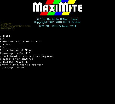

Posted: 02:04pm 12 Oct 2014
I can confirm this error - the same thing happens with me.
If I use a name such as HELLO1, this saves fine.
If I use something like "HELLO ILL", MMBASIC throws up an error - File number is not open.
This despite OPTION ERROR CONTINUE.
You might have found a bug perhaps?
EDIT: Hang on - I am using command prompt, so the error report is probably correct for that method - I will write a little code to test this.....
EDIT: No, you are right - even with a code, it still fails with a file number not open error on line 2, even though I would also have expected MMBASIC to just ignore this error and save the problem in mm.errno.
[code]
Option Error Continue
SaveBMP "Hello ill"
Print "Done.",mm.errno
End
[/code]
My guess at this point, is that the Option Error Continue just does not work with saveBMP(and perhaps loadBMP too - not tested). There are no problems with normal file reading and writing in this respect.(using option-error-continue and checking the mm.errno variable)
