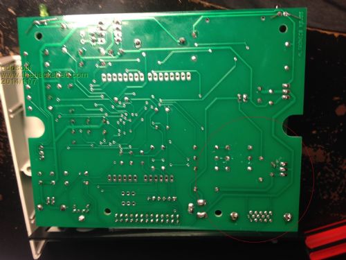

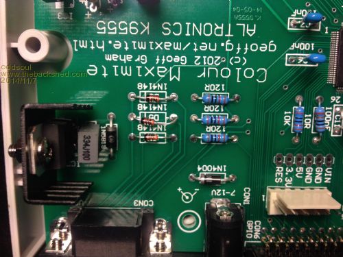

I don't have enough technical knowledge but have tried to find out the issue.
I have 2 images of the PCB showing both sides of the board.
- I have checked all solder points and they seem fine
- Double checked resistors (The right value)
- Diodes seem to be in the right orientation
I'm not sure what a CRO is and I also don't have a multimeter that I can use to measure the outputs.
Will try to find one otherwise please correct anything

Everything looks OK but my aging eyes have enough trouble checking resistor colour codes in the flesh, much less looking at a photo.
Without a multimeter, testing gets a bit difficult.
A CRO is an Oscilloscope, very helpful here.
How are you powering the maximite?
Can you test with a different monitor?
The outputs from the processor swing from zero to 3.3 Volts.
With a monitor connected (with 75 ohms input resistance) the monitor inputs would end up swinging between zero and 1.2 Volts. The diodes keep this from zero to 0.6 Volts.
Because the output is mostly black, the voltages are mostly zero so using a multimeter will give a reading of close to zero.
A CRO will show the brief high levels and this is what we need.
If you draw a white box the full size of the screen, the output will be mostly white so the voltages will be mostly high. Now a multimeter can get a close representation of the high voltage level.

I copied the image, magnified it by 50% and I can read the resistors. They are (right to left in the image) Brown Red Black Black Gold = 120 ohms. The diodes are the correct way according to the overlay.
In the absence of measurement, it's time to start substituting. Try a replacement cable and monitor. One sub at a time please.

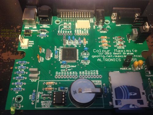

Well after all this time the issue was finally fixed
New Resistors:
Old Resistors:
If you look at the resistors in both images they were setup in the wrong orientation
-120Ohm were in place of the 10K and that was why the video output and clock were not working
Thanks to Geoffg for helping me with the issue.
I think we all need to stop and look and look again so we make sure that these things don't happen! But it still was a good experience!!
Now i'm off to program!
