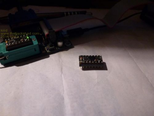

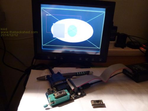

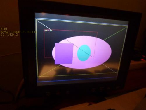

Joining the teasers with mine - a full-blown graphic controller in true DIP16 format (fits into a standard DIP16 socket/footprint). Here are some early pictures with and few random shapes and colours in them.
The control is via SPI and there is a nice set of simple built-in functions for text and graphics. The firmware is now very close to being complete. I will have this on the market soon with price tag around $12 per piece.

The device has 128k of RAM and the graphic mode is fixed (for now) at the standard EGA resolutions of 640x350 x16 colours. Text is EGA as well - 80x43 x16 colours. Text and graphics can be mixed and masked in many different ways. Fonts and sizes are supported as well. There are other nice functions, also supports sound and also a single channel analogue input for applications such as keypad or a slider.
Speed is no worse than a typical EGA controller from that age. It won't run well a modern 3D software engine, but that's not its purpose anyway.

Wow, kiiid, that is really impressive. I was happy enough with the 8 colours of the Maximite, but the Micromite paired with this thing of yours will give us 16 colours to play with.
Great work - I definitely want at least a couple to play with. The fact they are also in such a nice small package makes them beautifully intergratable.

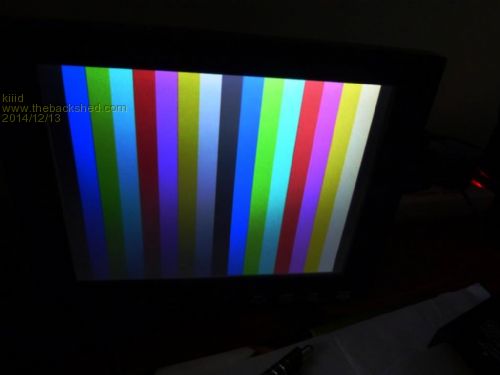

Here is another picture with the colours on my test monitor. Will keep the forum updated.

Awesome work Kiiid..!!
Excellent size layout...! You bet, put me down for one..! Instant video out for the uMite stuff... I could trade ya a 28 pin USB-RTC-FRAM board if wanted... Lou is finishing up the builds and we should have some to offer soon... I have 3 of them built here and working at my place...
