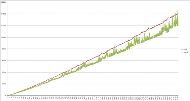

CaptainBoing
Joined: 07/09/2016
Posts: 2171
Posted: 08:28pm 12 Aug 2017
CR2 vs Comb time comparison
Comb is faster overall but I think the the graph demonstrates the interesting phenomenon of "worst case" order. A number of searches suffer from this but it is rarely likely to be a problem in real life, just unlucky if it is.
better resolution is available at the bottom of this article.Edited by CaptainBoing 2017-08-14
twofingers
Joined: 02/06/2014
Posts: 1772
Posted: 01:57am 13 Aug 2017
Hi Andrew,
as you know I really appreciate your commitment!
But I have some issues to use the CR2 sort, sorry!
In the range up to ~30 items it fails (for random data strings).
With your predefined data set I get errors for data sets with up to 14 items.
I think, you should know that.
I know that you have invested a lot of work, maybe it is just a small bug or
something system specific (floating point related?).

This is a test program for comparisation Comb vs CR2 sort.
Something to play with:
2017-08-13_114417_TBS_Comb_vs_CR2_Sort.zip
I hope, that makes things a little bit clearer ...
Michael
The lone and ...

Final words on the comparison: here
@twofingers Yes I have seen that in action too but can't really pinpoint the reason. I thought it might be because of the single precision nature of the maths too (the originals were double). However...
As this experiment has proven, there are better methods so beyond the academic exercise, there isn't much point in trying to iron out the problem please feel free to update the wiki though if you want to. I will edit the article to highlight the sort failure tho' just to stop it being used.
