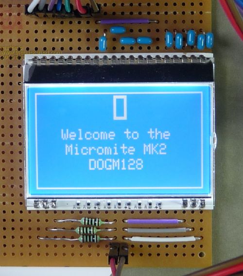

I received a request for a port of the graphics routines for the DOGM128 LCD display which uses the ST7565R controller.
So here it is
Pinout for CD (marked A0 on datasheet), CS, and RESET can be set in Basic. Pinout for the SPICLK and SPIOUT are of course fixed.
The Cfunctions are identical to the OLED and NOKIA SPI displays.
2015-01-31_113625_DOGM128-SPI.zip

Posted: 03:46pm 03 Feb 2015
I tried this with a Zolen ZLE12864B which is similar to the DogM128. The ZLE12864B uses the ST7565P controller rather than the "R" version. It ran but the contrast was poor and the screen lost the 8 left bits so when the Hello World screen came up I saw ello World. The ZLE12864B may require a few tweaks to the code to get it working.Edited by micronut 2015-02-05
