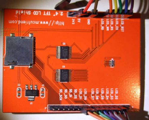

twofingers
Joined: 02/06/2014
Posts: 1773
Posted: 05:42am 04 Feb 2015
WOW, that's fast! Faster than I can boot up my PC!
Very appreciated!
I need only 11 connections to the MM? D0-D7,WR=9, RS=10, Reset
and VCC+GND + RD to VCC, CS to GND
Edited by twofingers 2015-02-05

MicroBlocks
Joined: 12/05/2012
Location: Thailand
Posts: 2209
Posted: 06:33am 04 Feb 2015
Peter,
Is it a correct assumption that you are using the parallel port in a 6800 configuration?
When choosing a LCD it is often one of the options to choose from. (The other is 8080).
In that case an extra pin is needed for the RD.
Is the choice 6800 or is it either possible?
Edited by TZAdvantage 2015-02-05
Posts: 11904
Posted: 06:35am 04 Feb 2015
No idea - RD is held high as I never read
