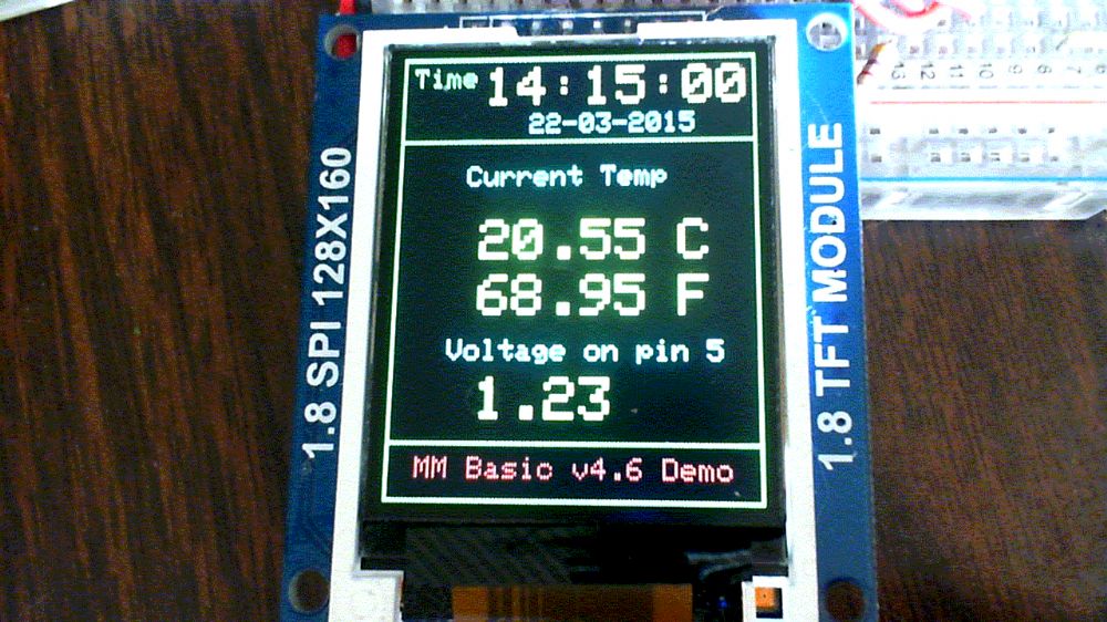

This is awesome..!
Just got the "B11" shot into the SkinnyMite...
I have the 1.8" 128x160 and the 2.4" 240x320 touch displays to test with...
Workin on it....

No problem fine Sir, this was one of your CFunctions for this S6D02A1 type beast. when running, it's just a basic demo doing some useful stuff...
The code was spun up for the 28pinner...
2015-03-22_194229_time-temp-volt_Demo_-_DIP-600-28_-_170core.zip
EDIT: I found the original code that I started from...
2015-03-22_203844_TFT-S6D02A1-SPIb.zip
I hope this helps...!

I've included support for the S6D02A1 in b13 . I'd appreciate if you could test it. It is also included in b20 for the ARMmite so please test that as well once you get the Discovery board up and running

MM v4.6++ B13 seems to work fine with the 1.8" TFT LCD Display using the S6D02A1...
I posted the feedback on the SkinnyMite Players thread...
Once again, Thank you Dr. Awesome..!
