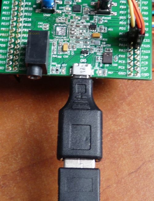

ARMmite B24
Two changes in this release. If you have any comments or questions, please start a relevant thread.
First:
The program will automatically load the time and date on reset if there is a RTC attached to the I2C ports. The operation of OPTION AUTORUN will not be impacted as no error will be displayed if there is no clock attached.
Second:
In this release I have removed the USB console option as it has not proved possible to get it to work reliably with downloads over xmodem if the program is more than a few lines long
However, I have added support for a USB keyboard
The syntax is : asciicode=USBKEY(timeout in msecs)
e.g.
dim integer i
do
i=USBKEY(1000) ' get a character or return 0 if more than 1 second elapses
if i then print chr$(i)
loop
You will need a microUSB adapter to plug in a standard keyboard as in the picture.
The program decodes all normal letters and numbers but does not respond to non-ASCII character such as "F1" etc.
Pin 15, PC0 is no longer available as a general I/O pin as the STM discovery Board uses this pin to switch power to the USB port when in USB Master mode
Edited by matherp 2015-03-31
