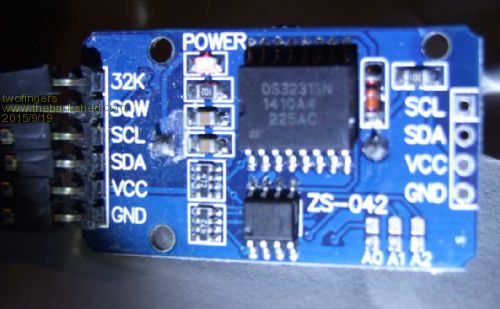

I have three 3231 modules all look the same but only one of them returns a trim figure the other two get the error message check the frequency.
They look identical and the 32 Khz pin on the 3231 is connected to the output pin.
Puzzled.
Cliff

  centrex said   They look identical and the 32 Khz pin on the 3231 is connected to the output pin.
to the output pin?
I have no idea. Can you check the signal on PIN1 (DS3231 chip)?
AFAIK the 32khz signal should be on (if powered by VCC):
  Quote  Control Register (0Eh)
Bit 7: Enable Oscillator (EOSC). When set to logic 0, the oscillator is started. When set to logic 1, the oscillator is stopped when the DS3231 switches to VBAT. This bit is clear (logic 0) when power is first applied. When the DS3231 is powered by VCC, the oscillator is always on regardless of the status of the EOSC bit. When EOSC is disabled, all register data is static. (MAXIM DS3231 manual p.13)
This is my DS3231:

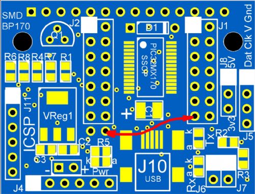

Hi Michael, All,
I have tried it on my SMD BackPack 170 which uses a DS3232 8pin RTC chip and it seems to work as well.
FYI here is where to link the 32kHz signal to Pin(16)
