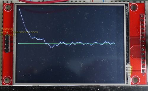

In the tutorial thread on CFunctions I developed a PID controller algorithm that can run completely transparently in the background on a uM2 or MM+.
However, I do realise that many BB members may not want to wade through a treatise on CFunctions
I thought it may be worth posting the Basic code as separate thread if it is useful for any control applications.
The code reads a user-specified analogue channel and controls a digital output using a coarse PWM to attempt to make the analogue input equal to a pre-defined setpoint. The setpoint is specified in ADC counts (0-1023) rather than voltage.
The PID controller code has the usual inputs of Kp, Ki, Kd and a bias setting.
Variable dt controls the PID loop time in millseconds you can set this to any required value but below 100 the output control will be somewhat coarse. The PWM will switch on the output for a calculated fraction of the loop time.
I tested the attached demonstration code using a thermistor to measure temperature and control a heater using a transistor switch.
The code uses the algorithms for themistors in this post
The example code plots the error between the setpoint and the measured temperature on a TFT display in my case a ILI9341
I'm not going to go into the techniques for tuning PID parameters, use Google for that. But the code does allow them to be changed in Basic and the PID control loop will be immediately updated.
There is no requirement for any Basic code once the PID has been set up but in the example I display the error each time through the control loop. I do this by checking for a change in the PIDs internal loop counter which is available in the PID controllers data block.
If you don't call the fucntion to turn off the controller "i%=PID(1,myaddr%)" it will continue running in the background even after the Basic program has terminated and control returned to the command prompt.
Any questions please ask - unless it is about tuning the PID constants

i%=peek(word PIDdata%) 'get the current loop count
if i%<>j% then 'If the value changed log the current error
logvalues(PIDdata%)
j%=i%
endif
loop while k%<640
i%=PID(1,myaddr%) 'turn off the PID controller
end
sub logvalues(address%)
local i%,measured_value%,fvaladdress%
i%=peek(word address%+4)-1024 'get the error i.e.the difference between the meassured value and the setpoint
print "error is ",i%
if i%>-120 and display then
pixel k%\2,i%+120,rgb(white)
k%=k%+1
endif
end sub
