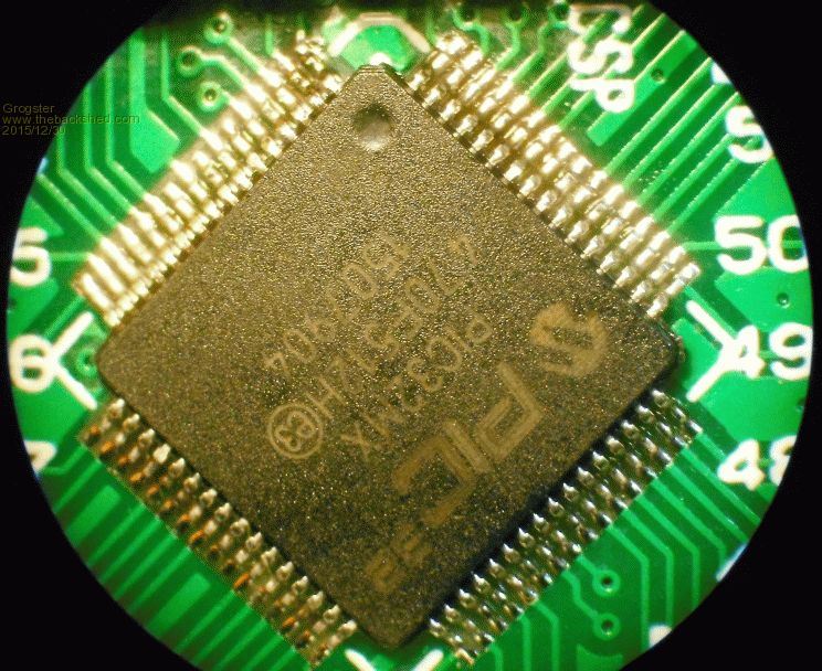

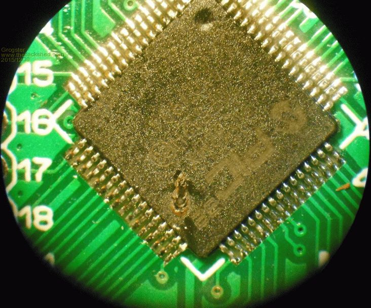

I had just finished my new prototype board, and realised I put the wrong firmware in it, and replugged the 13.8v into what I THOUGHT was the supply, but was actually the line coming from the external opto-coupler. This put 13.8v on the 3v3 input.
The PIC32 did not really thank me for that.
I knew it was all over when I saw a bright orange spot coming from the IC, but before I could rip out the power, there was a crack sound and a whisp of smoke.
...and we all know that it is the secret smoke that makes things work, and once it escapes, the thing don't work no more...
*sigh*
Posts: 10044
Posted: 01:38am 30 Dec 2015

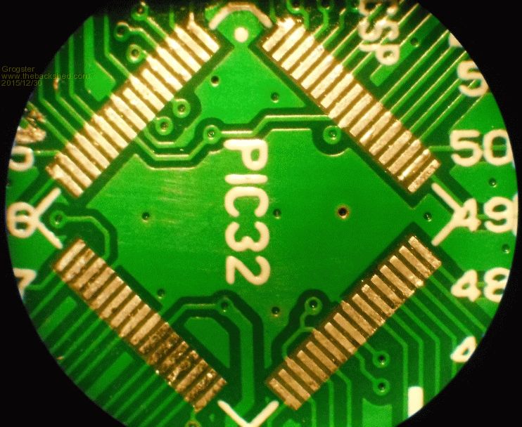

Deceased PIC32 removed, and footprint clean ready for new chip.
At this point, I fired the board back up again, and checked all system voltages and other critical areas, just to be sure that this fault did not kill one of the regulators in the process or cause one of them to put out an unhealthy voltage or something, that might cook the new one too - not what anyone wants!
Posts: 10044
Posted: 02:06am 30 Dec 2015
...and an hour later, we finally are back to the land of the electronically-living.
It was about the time I expected it to take.
Chip-Quik is amazing stuff - I'd be lost without it.

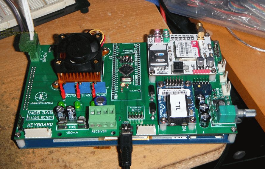

Out of curiosity, what is the board like in full?

Here you go:
This is the board I replaced the chip on, and I did it with both the fansink and the EfCom module(white module at top-right) both still in place.

Posted: 12:01am 31 Dec 2015
GEEZ GROGSTER... What have you made???? This looks very cool with all those modules!
Posts: 10044
Posted: 12:25am 31 Dec 2015
Hey there.
It is a scaled down version of this board on this thread that I made when I was basing everything on a colour Maximite unit.
The Micromite Plus has so many new features, I basically decided not to bother rolling out the Maximite-based unit, in favour of a complete redesign to take advantage of the power of the Micromite Plus chip.
The GPU fansink is used to cool off three LM350 regulators in cascade arrangement(sometimes called 'Pre-regulator') to provide the three system board voltages of 9v, 5v and 3v3. Current can be a couple of amps surge when powering the network and cell-phone module(the white one) at the same time, and the LCD backlight is quite thirsty too.
