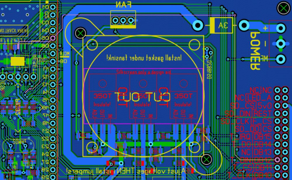

Hi folks.
1) Program firmware B37
2) Cycle power
3) Connect USB console
4) Issue: OPTION LCDPANEL SSD1963_7,L,4
5) Restart MM as requested(cycle power)
6) Connect USB console
7) Issue: OPTION TOUCH 22,21,45
8) Restart MM as requested(cycle power)
MM+ dies.
LCD backlight blinks off and on at 1 second intervals, just a short "on" blink.
USB console dead, native console dead. You have to reflash the chip to get the console back.
Does anyone know why that should be?
I also tried leaving off the pin45 reference on the touch command, but the same thing happened - continuous attempt to initialize the LCD that the MM cannot get out of.

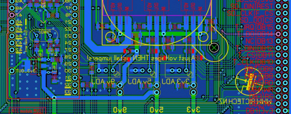

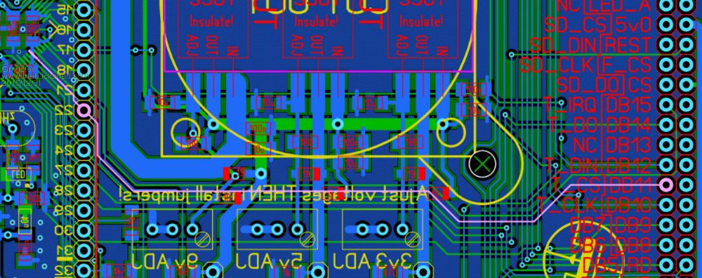

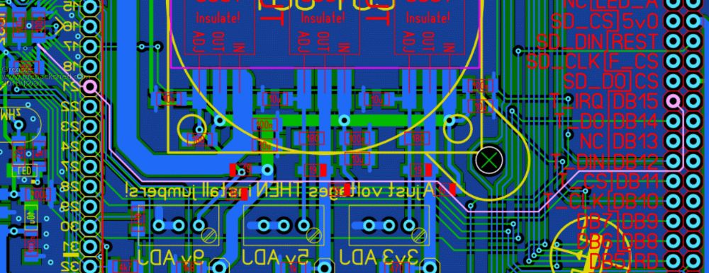

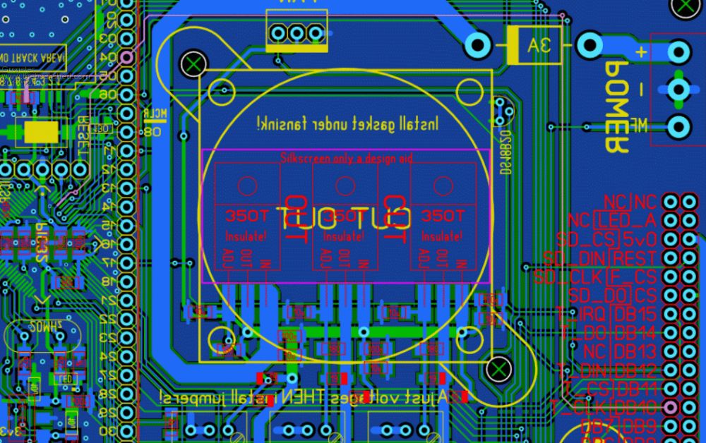

Images of the track layout: (Relevant track in each image is highlighted in pink)
Everything looks just fine to me, so I don't understand why as soon as you run the touch command, the MM+ falls over.
Can anyone else throw any light on what might be going on?

Posted: 05:13pm 30 Dec 2015
Silly question
I you leave off the Option Touch completely does the LCD work ?
Jman
Posts: 10044
Posted: 05:32pm 30 Dec 2015
YES - LCD works just fine, UNTIL you issue the OPTION TOUCH command, then it all falls over.
GUI TEST LCDPANEL works just fine to test the display(while it is working!)
I have another LCD, so I might swap them and see if I have any more luck - PERHAPS I have a crook touch controller or something on this LCD.
EDIT: It's not the LCD - the exact same thing happens on a known-good one.
I will now setup a MM+ unit and connect up the LCD to it, to see what happens with the exact same pin choices.Edited by Grogster 2016-01-01
