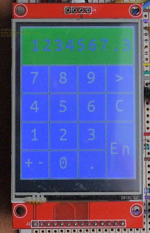

Nothing original but may be useful for those using the MM2 rather than MM+
This code demonstrates a function that draws a keypad on a 240 x 320 screen in portrait mode (2.8" ILI9341 in this example) and allows the user to enter any number up to 9 digits, signed or unsigned "+-", with or without a decimal point. It supports character delete ">" and cancellation "C"
I think I've programmed in most protections and tried to mimic the way a standard calculator input works.
After the ninth characters further input is ignored except the delete char key
Only one decimal point allowed
Decimal point not allowed as 9th character.
I've included the font I've used in the source.
The way the touch input works is deliberately slow (human time) to ensure there are no unwanted repeat character. This seems to work well and the touch is fully usable with a British Standard Index Finger - no need for a stylus etc.
All feedback appreciated.
' Demo of touch number input
option explicit
option default none
cpu 48
' OPTION LCDPANEL ILI9341,L,24,16,15
' OPTION TOUCH 10,9
const T_IRQ = 9 'pin for touch interrupt
' set up the coordinates of the buttons
dim INTEGER pos1(3)=(2,201,57,57)
dim INTEGER pos2(3)=(61,201,58,57)
dim INTEGER pos3(3)=(121,201,57,57)
dim INTEGER pos4(3)=(2,141,57,58)
dim INTEGER pos5(3)=(61,141,58,58)
dim INTEGER pos6(3)=(121,141,57,58)
dim INTEGER pos7(3)=(2,82,57,57)
dim INTEGER pos8(3)=(61,82,58,57)
dim INTEGER pos9(3)=(121,82,57,57)
dim INTEGER pos0(3)=(61,260,58,57)
dim INTEGER possign(3)=(2,260,57,57)
dim INTEGER posdel(3)=(180,82,57,57)
dim INTEGER pospoint(3)=(121,260,57,57)
dim INTEGER posenter(3)=(180,201,57,116)
dim integer posdisp(3)=(2,2,235,78)
dim integer poscancel(3)=(180,141,57,58)
dim touched$ length 10 = ""
DIM integer dp,ret
dim s$
do
s$=numberpad$()
if s$="" then : print "Entry cancelled": else: print val(s$) :endif
pause 100
loop
end
sub touchint
if touched$="0" or touched$="-0" then dp=0 'decimal point always zeroed on empty string
if len(touched$)<9 then 'add a character to the string if not full
if testtouch(pos0()) and touched$<>"0" AND touched$<>"-0" then touched$=touched$+"0"
if testtouch(pos1()) then addchar("1")
if testtouch(pos2()) then addchar("2")
if testtouch(pos3()) then addchar("3")
if testtouch(pos4()) then addchar("4")
if testtouch(pos5()) then addchar("5")
if testtouch(pos6()) then addchar("6")
if testtouch(pos7()) then addchar("7")
if testtouch(pos8()) then addchar("8")
if testtouch(pos9()) then addchar("9")
endif
if testtouch(possign()) then 'change sign, can't go negative if string full
if left$(touched$,1)="-" then
if len(touched$)<9 then touched$=right$(touched$,len(touched$)-1)
else
touched$="-"+touched$
endif
endif
if testtouch(posdel()) and touched$<>"" then ' delete a character
if right$(touched$,1)="." then dp=0
touched$ = left$(touched$,len(touched$)-1)
if touched$="" or touched$="-" or touched$="0." or touched$="." then touched$="0"
endif
if testtouch(pospoint()) and dp=0 and len(touched$)<8 then 'add a decimal point, can't add if no room for at least one digit after
if touched$="" then touched$="0"
touched$=touched$+"."
dp=1
endif
text 236,posdisp(1)+posdisp(3)\2,space$(9-len(touched$))+touched$,RM,9,,RGB(blue),RGB(green)
if testtouch(posenter()) then ' return with valid string
SETPIN T_IRQ, OFF
ret=1
endif
if testtouch(poscancel()) then 'return with null string
SETPIN T_IRQ, OFF
touched$=""
ret=1
endif
end sUB
function testtouch(position() as integer) as integer
if touch(x)>=position(0) and touch(y)>=position(1) and touch(x)<=position(0)+position(2) and touch(y)<=position(1)+position(3) then
testtouch=1
else
testtouch=0
endif
end function
sub drawbutton(posn() as integer, s$)
box posn(0),posn(1),posn(2),posn(3),,,rgb(blue):text posn(0)+posn(2)\2,posn(1)+posn(3)\2,s$,CM,9
end sub
sub addchar(s$)
if touched$<>"0" AND touched$<>"-0" then
touched$=touched$+s$
else
if touched$="0" then: touched$=s$: else: touched$="-"+s$:endif
endif
end sub
function numberpad$() as string
cls
touched$="0"
colour rgb(white),rgb(black)
BOX 0,0,240,320
BOX posdisp(0),posdisp(1),posdisp(2),posdisp(3),,,RGB(green)
text 236,posdisp(1)+posdisp(3)\2," 0",RM,9,,RGB(blue),RGB(green)
colour rgb(white),rgb(blue)
drawbutton(pos0(),"0")
drawbutton(pos1(),"1")
drawbutton(pos2(),"2")
drawbutton(pos3(),"3")
drawbutton(pos4(),"4")
drawbutton(pos5(),"5")
drawbutton(pos6(),"6")
drawbutton(pos7(),"7")
drawbutton(pos8(),"8")
drawbutton(pos9(),"9")
drawbutton(posdel(),">")
drawbutton(possign(),"+-")
drawbutton(pospoint(),".")
drawbutton(posenter(),"En")
drawbutton(poscancel(),"C")
SETPIN T_IRQ, INTb, TouchInt
ret=0 'marker to return from function - set in interrupt
dp=0 'marker to indicate decimal point used
do
pause 1000
loop while ret=0
numberpad$=touched$
SETPIN T_IRQ, OFF
end function
