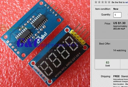

Hello,
Inspired by this link:
idea
This is an example for interfacing the 4 digit display from Qifei.
Sorry, the display can only show one single digit at a time.
So we need to time multiplex the display fast enough, and
with the Basic interpreter is not so good. (like software controlling
a stepper motor...)
Here are the picture, and MM44 program.

'48-7SEG7495.BAS
'4-BIT DIGITAL TUBE MODULE BY QUIFEI
'2016.03.08
'DRK V1.0
'VCC SCLK RCLK DIO GND
'3.3V CLK STRB MOSI GND
'TWO 8 BIT SHIFT REGISTER (74HC595)
'ONE FOR 7 SEGMENTS + DP
'+--0--+
'5 1
'+--6--+
'4 2
'+--3--+ +7
'THE OTHER FOR DRIVING DIGITS WITH MULTIPLEXING:1,2,4,8
