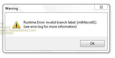

Posted: 01:39am 05 May 2016
Macro | Run returned an error for me:-
Can't find the location of the log file though.
Phil
Posts: 6607
Posted: 12:05pm 05 May 2016
Thanks Phil, This version has the typo fixed.

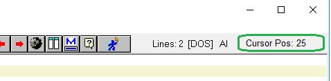

Posted: 08:48pm 19 May 2016
@TassyJim
Would it be possible to have MMEdit display the current position of the cursor on the line, in the blank toolbar area on the right (assuming you have the window sized sufficiently wide)?
Something like the example in the image below (highlighted in green). Its not a biggie, but it would make it really easy to keep comments at the right side of the code all starting in the same column.
Thanks,
Phil.
Posts: 6607
Posted: 09:45pm 19 May 2016
  erbp said   @TassyJim
Thanks,
Phil.
It would be nice but the current versions of MMEdit are struggling enough to keep up with keyboard entry.
I am not keen on slowing things down any further.
It is something that is in the list for the (long way away) new version which is built with a much faster programming language.

Posts: 6607
Posted: 10:30pm 21 May 2016
@erbp
I have done some experimenting and I can put a marker line at any, user selected column.
Not what you asked for but it can be used as a marker for aligning comments.
It won't have any adverse effects on the speed of the program.

erbp
Joined: 03/05/2016
Posts: 195
Posted: 12:10am 22 May 2016
@TassyJim
The marker line idea would be great. In fact it may be even easier to use than having the cursor position displayed. Thanks!
