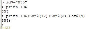

Don't quite understand the purpose of the string you are trying to send.
In particular the last 3 ASCII characters.
FF ETX EOT
And also, the string being sent will end with CR LF.
But Try a few things at the command prompt.
[Code]> dim id$ as string
> id$="855"
> print ID$
855
> print ID$+Chr$(12)+Chr$(3)+Chr$(4)
855
[/code]
It actually shows up differently on the screen, as far as the 3 low order characters go.
Why are you trying Chr$(8) 5 5 etc wouldn't this be correct?
[Code]> print Str$(8)+Str$(5)+Str$(5)+Chr$(12)+Chr$(3)+Chr$(4)
855
[/code]
As far as stripping out the digits is concerned, something like this would work,
[Code]print id$
855
> print mid$(id$,1,1) : Print mid$(id$,2,1) : Print mid$(id$,3,1)
8
5
5
[/code]
Phil
