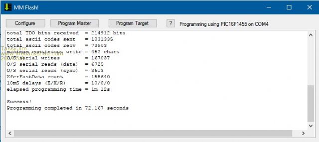

A year or so ago, I wrote a Windows GUI wrapper for pic32prog to make it easier to program micromites using an Arduino or micromite.
Now that we have the Microbridge, I have updated my program to add the Microbridge to the list of supported devices.
I have often used the Arduino method and found it quicker than using the PICkit3.
Now I have a MMX board with the Microbridge built in, I find programming the MMX a breeze.
MMFlash doesn't let you do anything more than you can using pic32prog.exe directly, but I like to think it's a bit easier.
All the hard work has been done by Robert Rozee and Peter Mather. I did the easy bit.

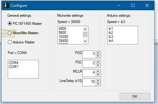

The only thing to configure for the Microbridge is the COM port
Programming the MMX takes about 72 seconds.
MMflash can be downloaded from my website
https://www.c-com.com.au/stuff/MMflash.zip
Unzip the contents to a convenient folder on your PC. It has to be writable so in Program Files is not a good idea.
No doubt, there will be plenty of reports about antivirus programs not happy.
VirusTotal gave 1 out of 61 unhappy which is better than usual.

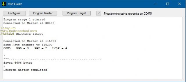

Hi TassyJim
I just tried the new version not sure it worked the old version showed progress bar when programming the master the new doesnt.
Do I have finger trouble
Cliff

  centrex said   Hi TassyJim
I made some changes to the way my program updates the text box.(Trying to stop some silly Windows stuff)
I didn't test programming the either the Arduino (which should be OK) or the micromite.
It is likely that I need to do more work there.
What device are you using?

Just 28 pin version.

Posted: 07:28pm 03 May 2017
Try downloading from my website again.
It should look better now.
I think the programming did happen, just no progress reported so any problems would have been hard to see.
I am not set up to do any actual programming with a micromite so confirmation that that part works would be nice.

Posted: 08:07pm 03 May 2017
That fixed it can now see the little dots scampering across the screen.
